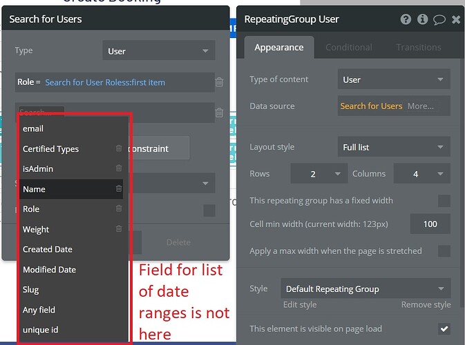

When dispatchers create a booking, I want a repeating group of Pilots to be filtered by if they are available for that time or not…but I’m having a hell of a hard time trying to figure out how to do this.
Where I’m running into an issue is with the Repeating Group. Bubble will not allow me to use the list of Date Ranges as a way of filtering. Why? I have it set up as a Bookings column which contains a list of date ranges assigned to them based on whatever Bookings they are attached to.
Basically what I am trying to do is compare the date ranges assigned to the Pilots to the date range selected by the Dispatcher when creating a booking, then only showing Pilots who do not have a conflict.
