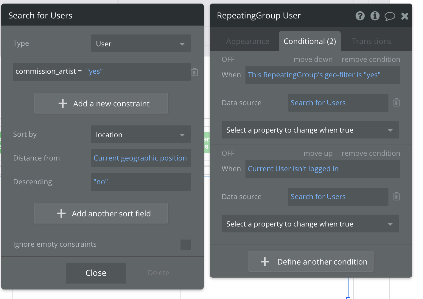

/edit - ok I have given up on doing this based on a dropdown. Instead I can do it based on the geographical location of the user, if they allow location based services.
So I switched to sort by distance from Geographical Location. However, I now find that if the browser blocks location, then instead of just showing a default order, the Search returns no results at all. This doesn’t seem like the best way to handle this, as many people will not have location enabled in their browsers. Any ideas?
Yes…the method I outlined in my first response should work if you get it set up properly.
