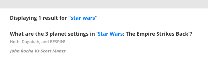

So as you can see from the images below, I’m using the input to search for questions & answers that contain the word “Star” or “star”. The search is case insensitive which is great! The question is displayed in both scenarios.
However when I use the “find & replace” function to change the color of the text being searched to blue, the “find & replace” function is case sensitive.

I found an interesting error @mishav.
When the question I’m searching uses “”, an error occurs. My solution to this was to change the “” to ‘’. That worked fine but is there anyway you see a way to still have “”?
See example below
When using ‘’ in the question, everything is perfect!
When using “” in the question, there is an error, resulting in not displaying the question.

Well done finding that corner case!
Double quote messes up the javascript syntax because it is being used as a delimiter in the expression.
To fix this, need to escape the escape character, and the quote character.
To do this, use two find & replace operations:
replace \ with \\
replace " with \"
Or both at once with a regular expression:
replace (\"|\\) with \$1
Similarly, the text pattern needs to escape its delimiter / and the escape character:
replace (\/|\\) with \$1
