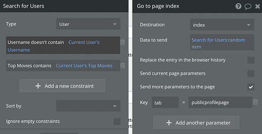

My users can save their favorite movies to the User data type with the field “Top Movies” which is a list. I want a button to be able to search for all users with one or more of the same favorite movies as them, and then navigate to one of those users randomly. I want the search for users to return all users who have at least one exact match in the current users Top Movies, which again, is type list. The setup I have below only works when one of the lists only has one entry so i need something beefier. I have not worked with intersect or filtering much, maybe one of those will help with this feature. Any ideas appreciated.
Also, the movie titles are pulled and saved via API, so different spelling isn’t an issue, every movie is spelled the same way. Thanks!
you have random item there, so its only going to return you one user. there may be a plugin that will return a list of random users, maybe like “list shifter” might do it.

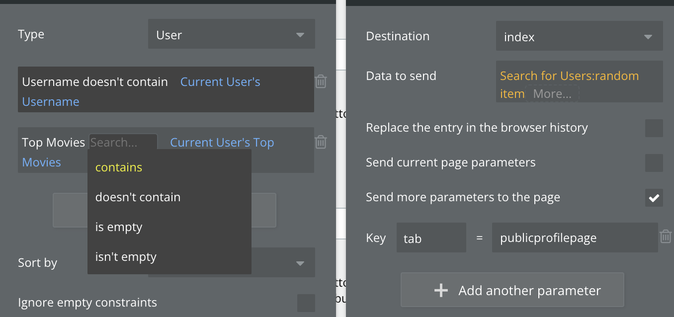

Where would i put the intersect function? it just gives me contains
Buildfactor (bubbleapps.io)
use the dropdown to select the user, and it will show you users that contain at least one text item that is the same

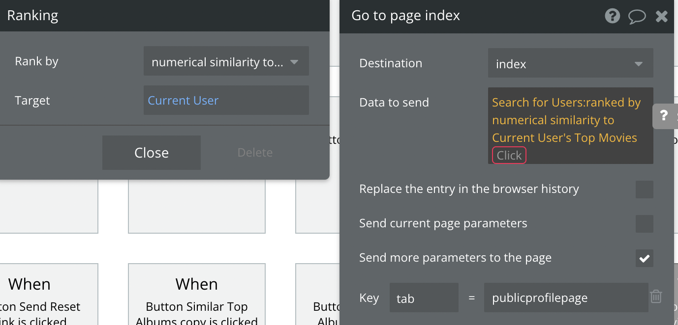

I believe all you’d just use Search for Users:ranked by numberical similarity to Current User
This should match all like users together.

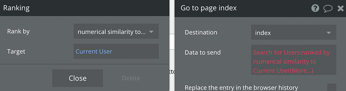

Ok and what would i put here? it cant just be that on its own.
Expanded:

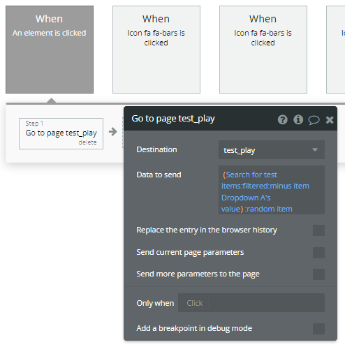

at the end of that exression you need to put random item, right now its a list, you need to make it one thing
this is what the numaricall similarity returns in the repeating group, im not so sure thats the answer i dont see how to specifiy what you are ranking the data types by.
only numarical difference and numaricall similarity, not comparing lists
