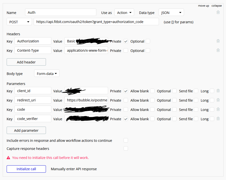

Hey I am trying to get Fitbit API oauth2/token access but its throwing the following error
There was an issue setting up your call.
Raw response for the API
Status code 400
{"errors":[{"errorType":"invalid_request","message":"Missing 'grant_type' parameter value. Visit https://dev.fitbit.com/docs/oauth2 for more information on the Fitbit Web API authorization process."}],"success":false}
Here are the screenshots
1-
2-
3-
I am properly passing all the parameters and headers but still showing this. I tried to use various variations but no success.
Here is the Fitbit API documentation
I tried to add the grant_type parameter in call then it shows the following error
In this case, it shows Expecting: application/x-www-form-urlencoded. I tried to look on forum regarding this but couldn’t find any proper solution.

Can you share screenshot? The original one have some issues related to use of auth + use of manual auth. This is not compatible. + Authorize url was not correct.

You have set body type to form data. Change for raw and in body set
grant_type=authorization_code&redirect_url=…
I’ve changed it to raw body, however, now it says “Authorization code invalid” although I’m sure code is correct.
I’ve attached screenshot and FitBit Tutorial curl, which works.
My raw body is not correct??
Code doesn’t last long. Clear what you have, request a new code, and go fast to copy and paste it to APi Connector and initialize it
Thank you so much. I’ve tried as fast as I can, but still I could not succeed.
I could use the same code in FitBit Tutorial curl to receive the correct Token after I failed it on the Bubble API connector, so I could not figure out why Bubble API does not work.
