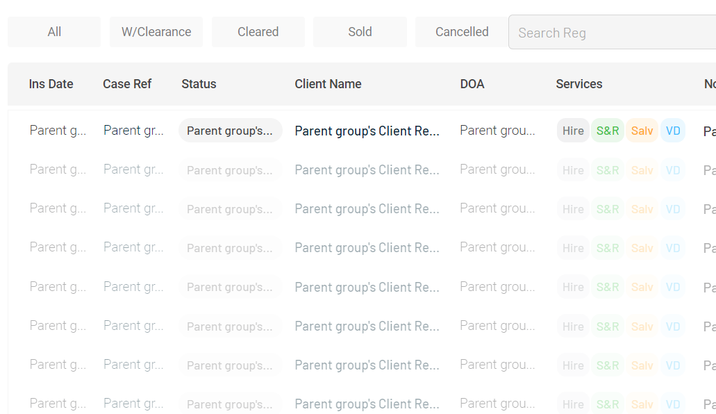

I want to create a box that appears when certain text is hovered, for example wen the client name is hovered in my RG a small box will appear with some extra info on the case.

ok great, so to clarify i am replacing the current text element i have in the repeating group with the new RE which always shows client name but then when hovered shows the Group Focus?

only issues with this is that when the hover box appears it stretches the height of the entire row which doesn’t really give the desired effect. The hover box ideally needs to appear floating over the RG
you must have your layout settings wrong then if that’s happening…
The ‘hover box’ can be any size you want it to be…
