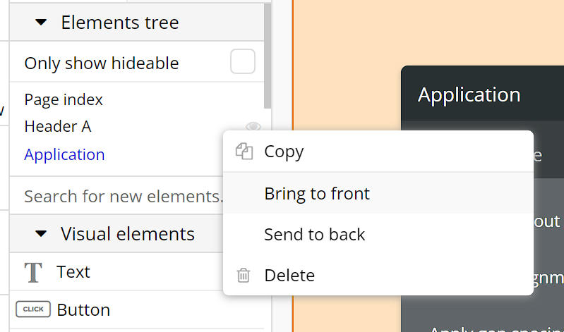

Hello @andreas2 When you set “above elements” to floating group inside a Reusable Element, its mean the floating is above the elements inside the reusable, but not necessarily at all application context, how to solve:
In element tree at editor: you can right click at the header and try: “Bring to front”:
or make the application “send to back”, with these two options you can control the index of elements.
Yes! That was it… So simple!
