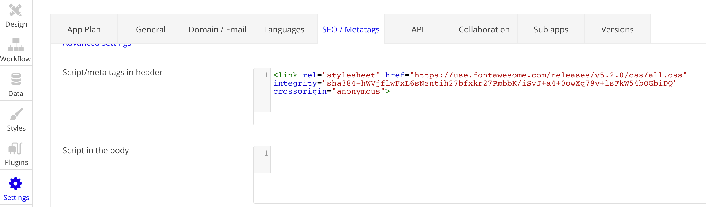

I did manage to get it to work for my use case by adding the FA style sheet link to the header of my app in Settings->Seo/Metatags and it seems to work fine so far.
I can use the 5.2.0 icons like (air freshener was released in 5.2.0):

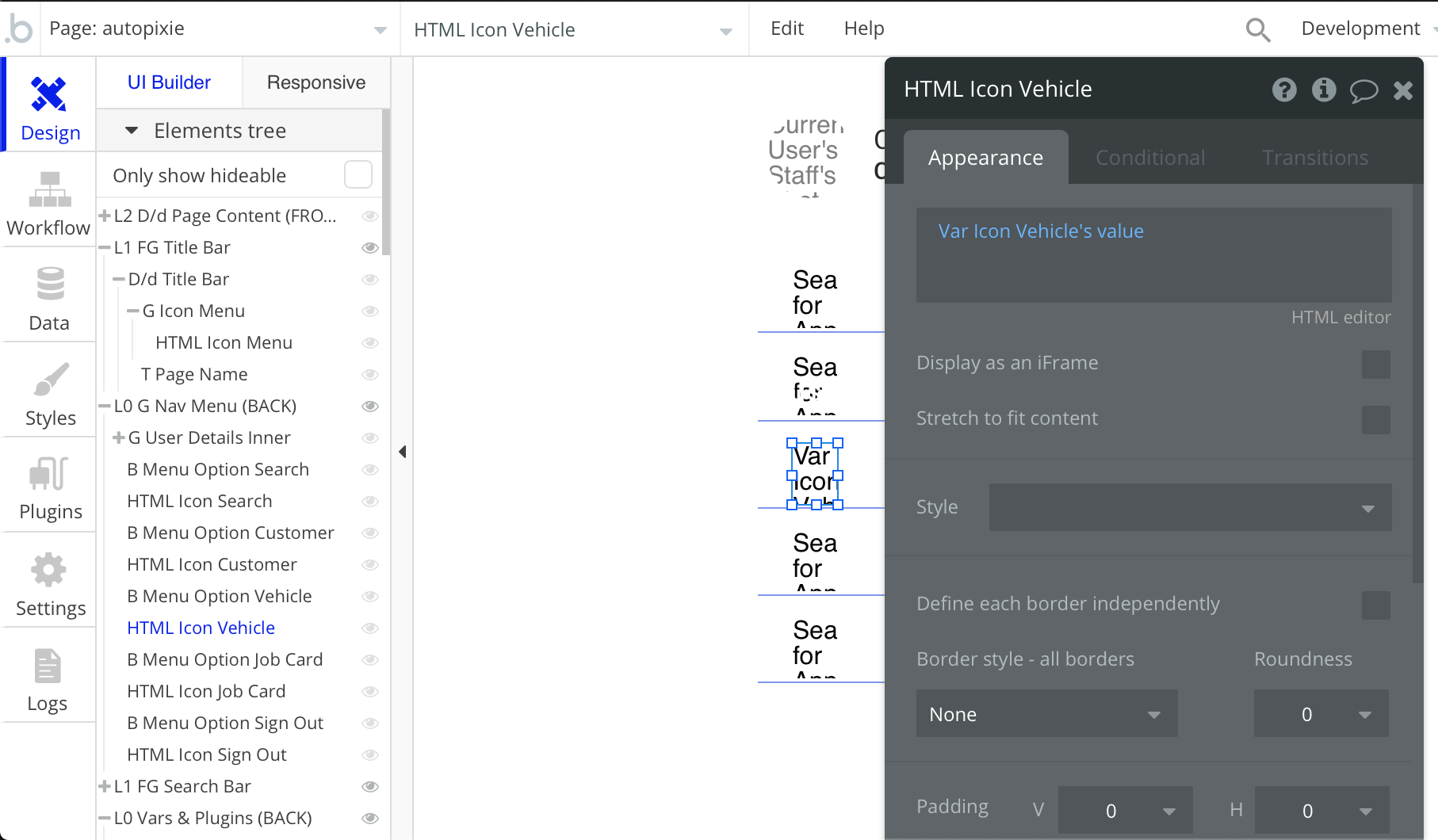

I’ve been out of commission for about four months @subtlemonsters so I’ve forgotten the bubble vocabulary and I’m not sure if I understand your question correctly so I’ve pasted screenshots below to show you what I’ve done. It works really well and there are hundreds of thousands of icons specified in HTML available, even multi-coloured and animated if you want that.

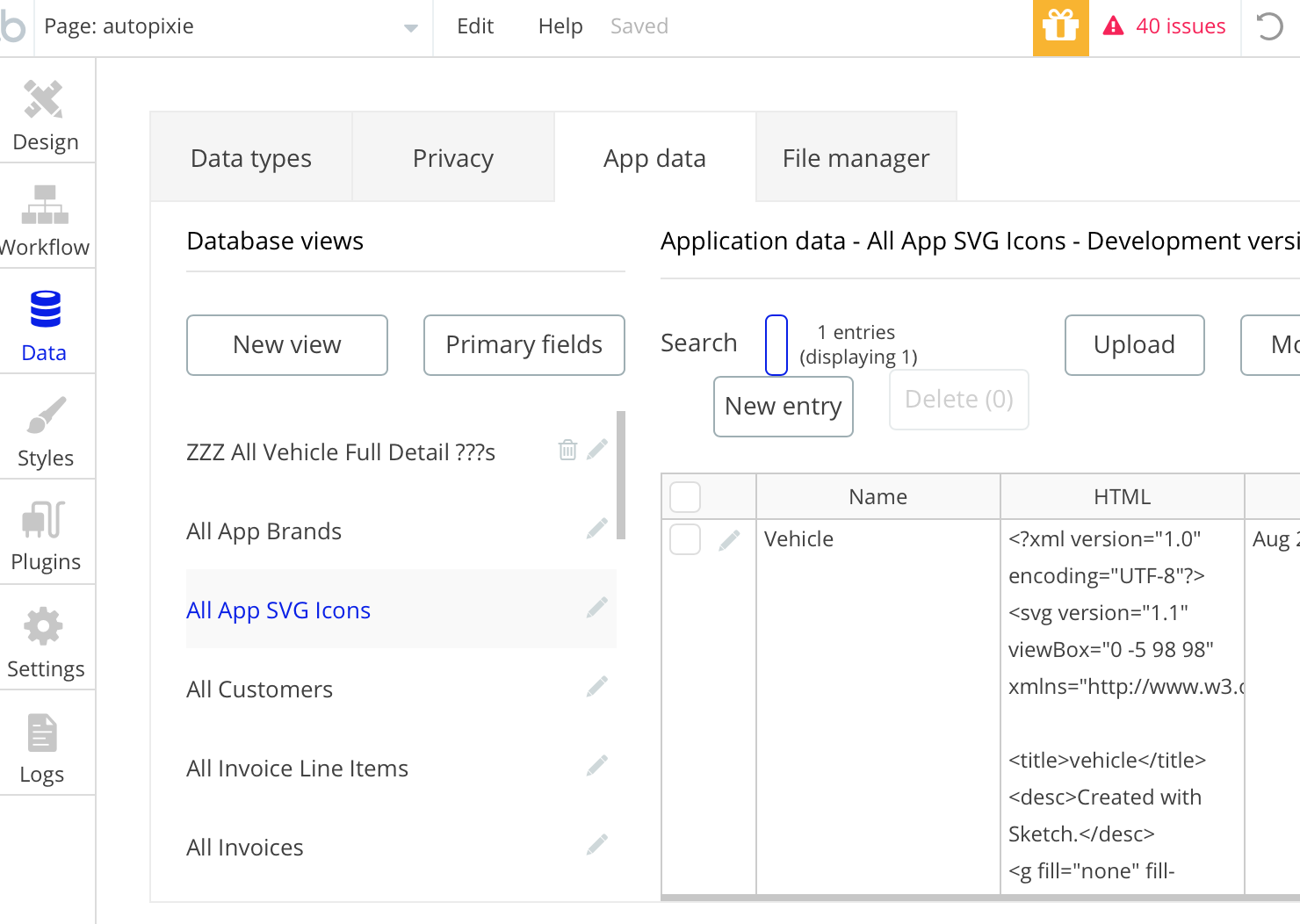

First I set up a Data Type/Table that has two fields (1) Name and (2) HTML

(1) In the first scenario I created a hidden text or input element of width=1 and height=0 and I called it a variable (old habits die hard).
Then every time I wanted to display the icon, I placed a HTML element on the page and set the HTML editor to point to that variable’s value.

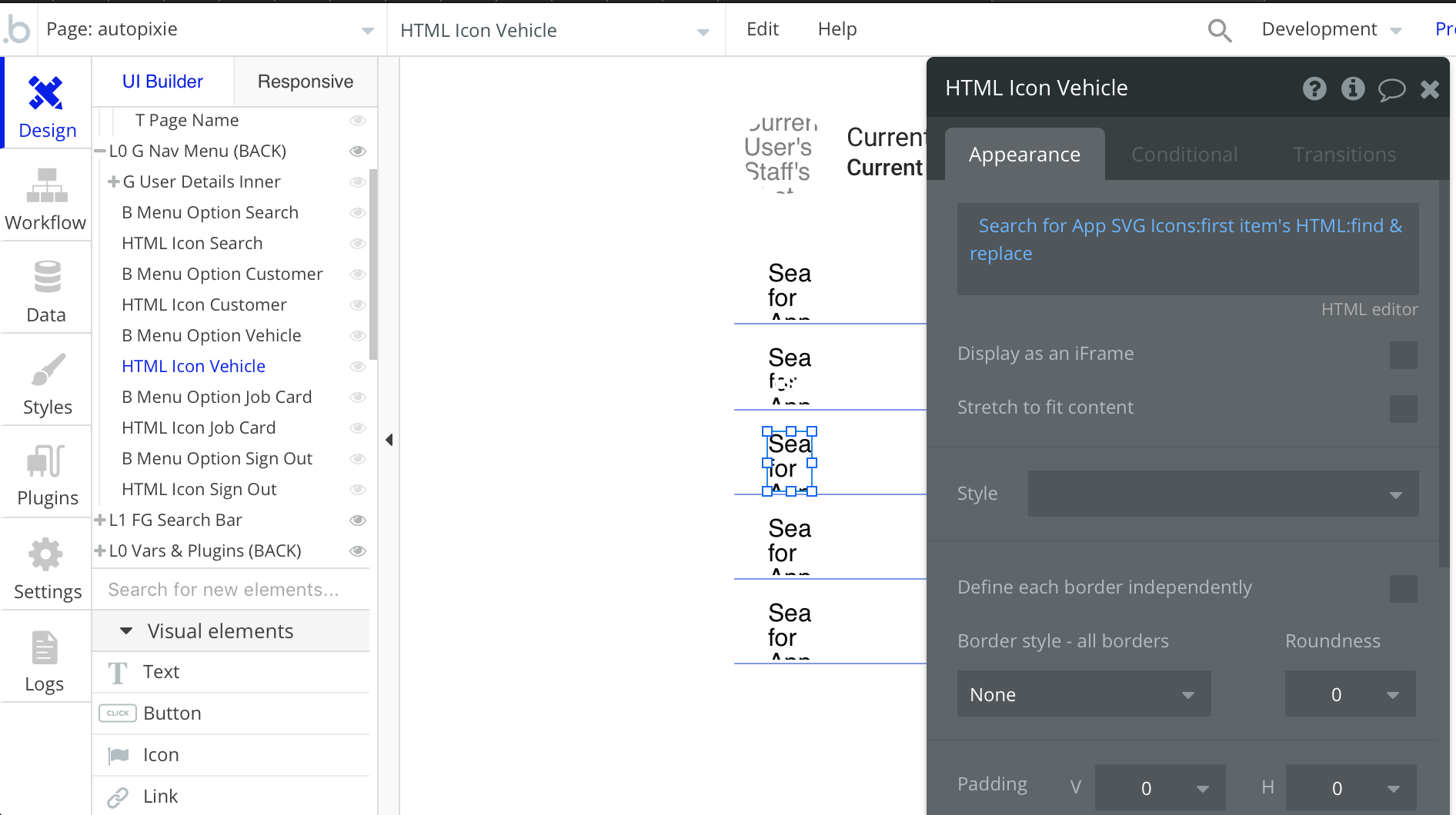

(2) bubble is smart enough about performance that you don’t need the variable element. Now what I do is simply have the HTML element make a call directly to the data table and bubble is smart enough to remember if it has already made that call so it does not do it again. That means you can eliminate the hidden variable elements … it’s easier on the brain.
You will also notice in the screenshot above that I use a Find and Replace. This allows me to change the hex color of the icon as required. So when saving icons to my Data Type, I set the hex color code to #000 then I find and replace with my desired hex code, or with a call to the brand colour’s data table if required.
This approach not only gives me access to endless icons, it also is very dynamic because it allows me to change an icon, or colour, in one place and know it will be changed everywhere.
