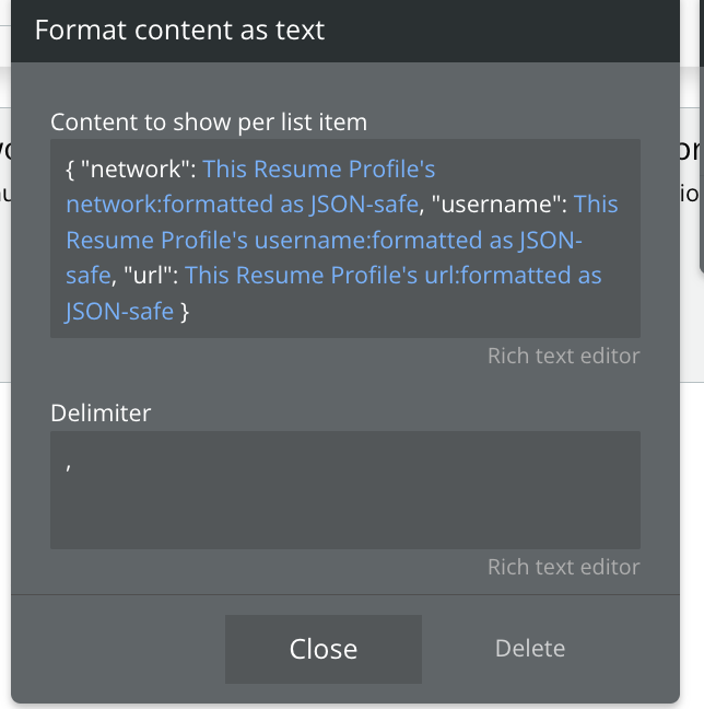

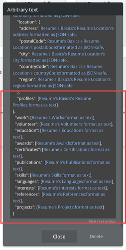

:format as text adds \n. This is a phenomenal pain in the ass when using format as text to structure arrays of objects in API calls.
For example:
After constructing this JSON structure for an API call, Bubble rubs salt in the wound and requires me to remove all of the line breaks that are inside any :format as text operators else the call won’t work! Seems like a checkbox to disable this behaviour would be such a simple solution.
The current best way to do it for me is to:
  1. Open the :format as text text inside the rich text editor
  2. Copy the contents of the RTE into a tool that removes line breaks
  3. Paste the line break removed content back into RTE
  4. Save

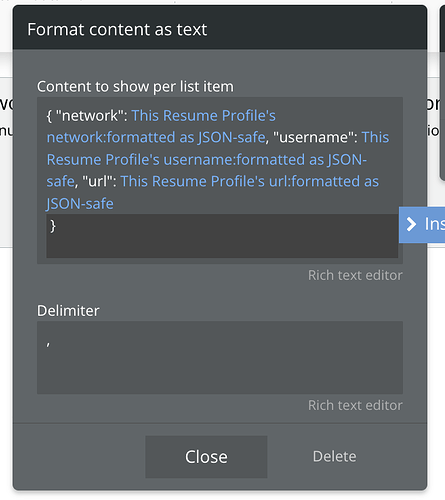

This :format as text has a line break after the final }, but Bubble will only show you that when you click on it.
