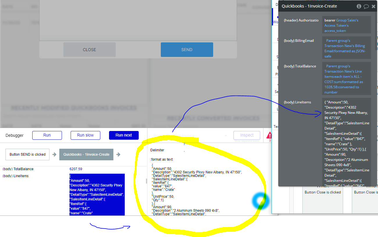

Having this same issue. My API call is correct, but I can only call it as static text rather than using dynamic data.
For example, I format the data as text and the output is as expected:
But this throws an error with my API. However, if I copy that :format as text from the debugger into the API call workflow and run it again as a test, it works fine, even though the content for both is exactly the same.
I’ve been going over this for hours and am almost losing it so any advise appreciated :grinning_face_with_smiling_eyes:
There’s probably a newline or something nested in there maybe? I think taking that text and let’s say you used postman, it should work. It’s just the way bubble is handling newlines. you just have to keep ‘typing’ as if it’s one long, run-on sentence. lol
So is Bubble inserting \n in there when format as text is used?
Yes they do
