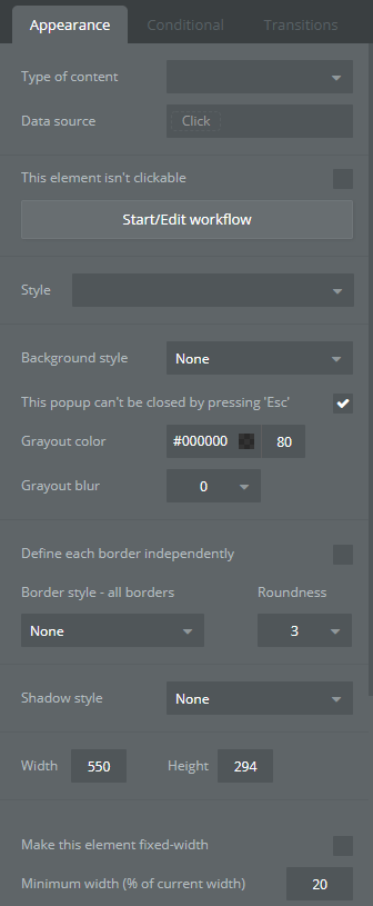

Hi @bentoj72,
Some good suggestions above. Thought I’d chime in. Here’s an example I use in one of my apps:
https://www.loom.com/share/d47fa3317f554a8cabd35e9a715224fa
It’s just a simple popup:
Using this plugin:
You could use @JohnMark suggested plugin alongside this to complete your request.
@lantzgould Thanks for the input. I’m going to attempt to use some of the code suggested to see if I can get a handle on it. Will probably use the popup idea if I get the code figured out to be able to “time” the blue progress bars visibility.
