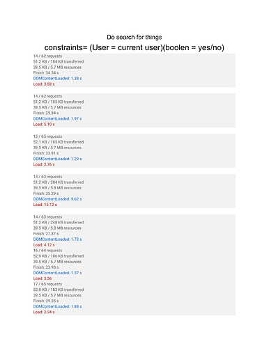

Here is the data. (Right click and select open image in new tab - to view the larger image)
(quick note: I only half know what I’m looking at here, I’m not 100% sure how to effectively understand the implications of why requests & transferred show two numbers (and with such variance between methods)
So here is my analysis:
a) Do a search does less requests (good?)
B) Total Load time (8 page refreshes)
(represented as a total, not an average / also I had 8 data (the picture only shows 7)
Search total load time = 42.39 Seconds
Filter total load time = 40.37 Interesting…
C) Total Finish time
Search = 231 Seconds
Filter = 182.64 Seconds
D) Transferred (overall doing a search appears to transfer less (assuming that’s a win?); however just for the hell of speculating, I represent it as a % instead: which led to an interesting outcome of which I don’t quite understand:
Search:
1st item = 28% transfer rate
item with largest load = 17% transfer
Filter
1st item = 4% Transfer
Largest load = 10%
And finally!
E) Resources (which looks like a win for search)
Search = 5.7MB
Filter = 6.9MB
Now keep in mind, the things that I am searching through are attached to the user data type. So does that mean that the search function already knows to search those data items, since there already attached to the thing?
- that would be fast for search
- but could cause some serious performance problems if you have 1000> items attached to the user, not because of the search but because you are seemingly loading some portion of all those items, everytime your reference the parent (such as a user, on a user profile page)
- notice how the Filter resources were larger than the search resources? That will likely prove to be a substantial exponential trend. Resources will go very high! if you have a large list of data things stored on another data type.
However if the search function does not know that the things to search are attached to the user - then it would default to searching the relevant data table.
- this is presumably much more scalable especially if Bubble does really have indexes that can very quickly find a list of 100 items in a datatable of 10M, if the search query uses the current user/user as a cross reference.
