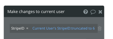

So you’d select the last invoice number and use “truncated from end to 5” which will strip out the last 5 digits, and then you’d convert it to a number. Now as a number you can add 1 number.
This isn’t the best example, so forget it’s a Stripe ID for a moment and imagine it’s the last item in the invoice table, or that my action is making changes to a user instead of creating a new record. But look at the argument in blue and it’ll give you the general idea
Screen Shot 2022-04-16 at 12.18.46 pm
The will result in 00004. So now you’d just need to add back on the first part. This could look something like this and would return AB-GH-
