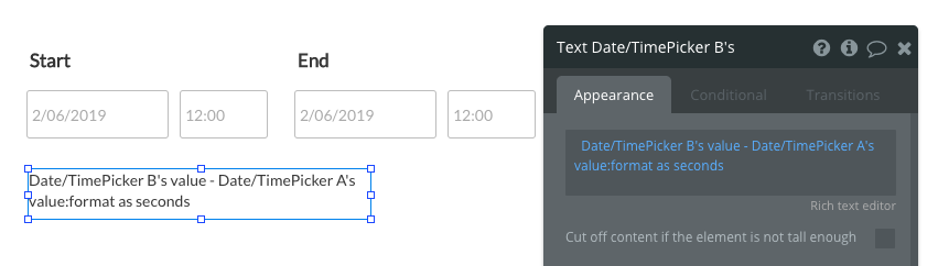

Please share a few screenshots of your expression setup. My recommendation is formatting as seconds, then doing the backwards math division and rounding to get the price value returned that you’re looking for.
I made a little app to try out your solution. I got it working but there’s a difference in how Bubble compute results:
12h15 - 12h00 in hours = 0.3h (wrong)
12h15 - 12h00 / 60 in minutes = 0.25h (right)

It might be helpful to scroll up from there, actually and read about the “date interval” type. When you subtract one date from another, this creates an object of “date interval” type (yes, it seems to be its own data type in Bubble)… as you can see here:

And, BTW, my screenshot in the reply above answers the original question: you can of course create a custom state anywhere on the page, set its type to Date Interval and then set its value with:
DateX - DateY
