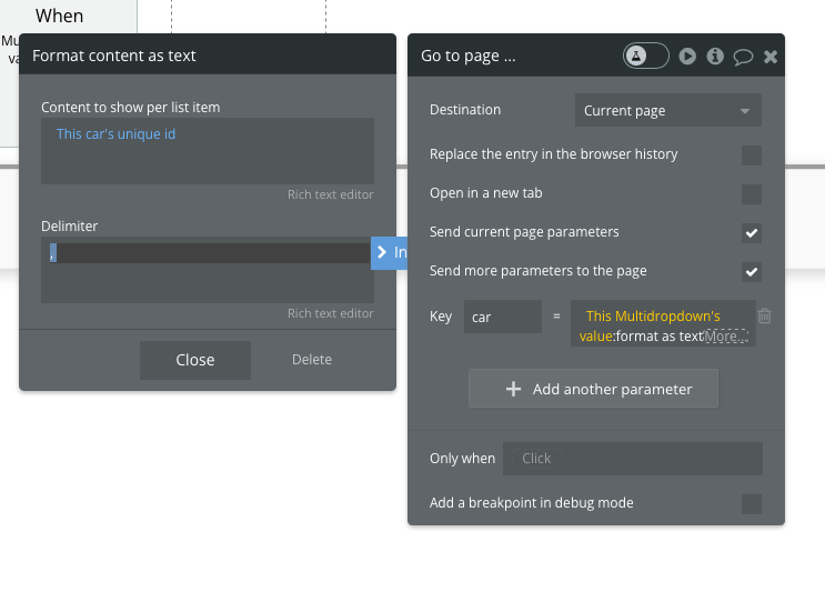

Get List from URL Parameter (List of Unique ID and Text)
Here’s how to get a list of things from the URL parameter. Link to editor below.
Getting one item from URL is easy. Getting a list of things from URL is harder, especially when it’s a unique id vs. text.
Once I figured it out, it’s pretty straight forward.
Link to the demo and editor
PRO TIP: by default bubble passes list of text delimited by a comma then a space , . They don’t do it by default on a list of uniqueIDs (things). To keep things standard it’s best to set your own rules of a comma followed by a space to delimit uniqueID
I’ve seen post about getting a list of options from URL, and an array of things from URL. Thought this would help. Option sets work the same as text described above.
Instead of format as text, you can also just use… :join with :wink:
@brad.h I think “Unique ID is in” is new functionality. In the past it was only = or <>. Now that we can use “contains” logic, this becomes a lot more straightforward! Thanks for sharing.
thanks! join with is not an option here. merge with?
No. Join with.
In your case: This multidropdown’s value’s unique id:join with ,

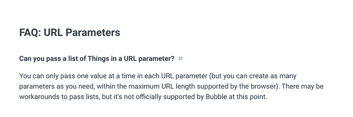

Bubble doesn’t officially support a list of Things in the URL parameter :frowning_face:. I’m wondering if I should revert back to custom states before going too far down this path.
I asked bubble support “why”. I’ll update this thread when I know more.
Yes you probably should not use URL parameters for a List UNLESS the max count of the list is ~3ish AND the filters for the list have a high WU consumption.

Exactly. My use case is an email with a link to the filtered results. I ended up not going this route since bubble does not support list of things in the URL.
did you check out this post - I’ve tried it and it seems to accomplish the goal of getting lists in the url parameters
Whether its working around bubble’s documentation is another matter but it seems to work
That doesn’t mean you can not set up your URL parameters to be a list of things and work with it properly. All it means is Bubble doesn’t have a feature to make it easy ‘out of the box’, which is why I had to post the tip linked above in 2020. It works just fine with no issues.
