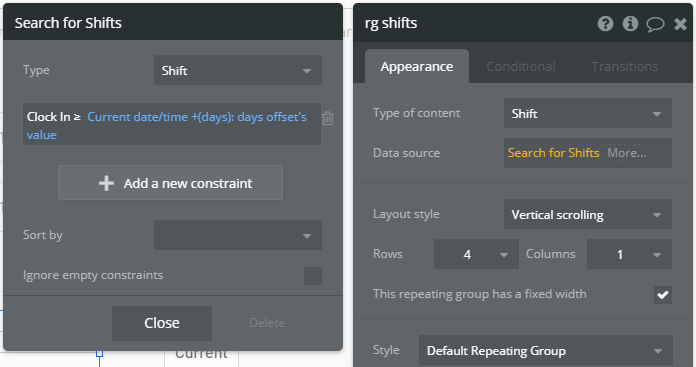

Sorry if my initial question was haphazardly worded. I will try to be more specific here. I have a list of entries stored under a data type. I want to sort this list so that I will have only entries that were AFTER the last sunday. I will show you what I currently have with this plugin, and why it doesn’t work.
The red circle is what will attempt to sort the entries of shift logs and then get the minutes of said logs and compare them to a minimum number.
The blue circle is the logic I’m using to try to get the date of the last Sunday. The first part that says “Next Sunday” is the plugin that was mentioned in an above response that does not seem to be working for me. Ideally, it would get the next Sunday and I would just subtract 7 days to get the last Sunday. However the problem was that the “Next Sunday” expression returned the current date.

Once you understand the concept I have described above, you should be able to use it to build a constraint that returns all of the things in your data type where the Clock In date is greater than or equal to the date associated with the most recent Sunday. Here is an example where the current date is used in the constraint…
Because I can’t find a way when building the constraint to extract the day from the current date and multiply it by -1 in the constraint itself, I added a hidden input to the page to get the number of days that need to be subtracted from the current date…
offset
Then, the constraint itself would look something like this…
You would obviously have to play around with this idea to get it to work for your exact purpose, but hopefully I was able to make the concept clearer so it can help you get down a path.

Thank you very much mike, this is exactly what I’m m looking for. I must have missed it in the documentation somewhere. Have a great week! -Matt
