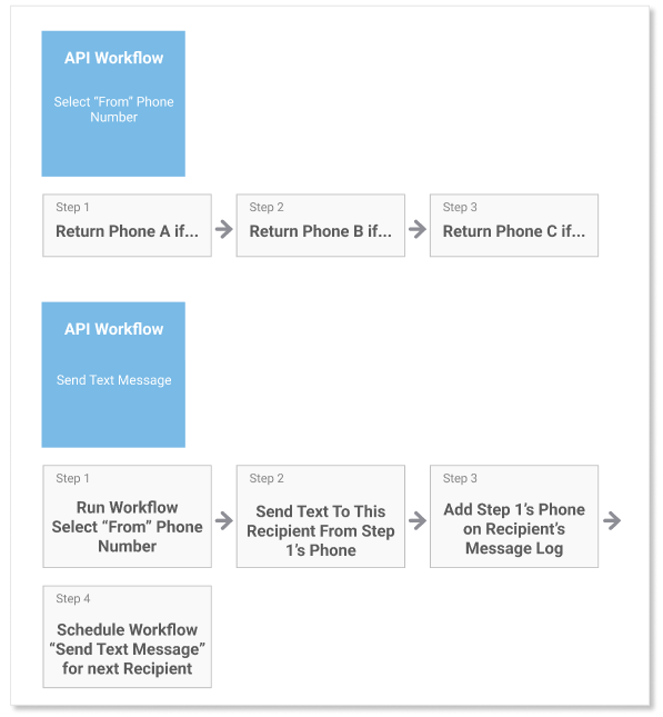

Yeah, this seems a touch silly. Confirmed that Return data from the API is only for publishing data in response to external API calls - which can indeed be consumed by a bubble app via the Bubble API connector as @keith points out. Not allowing this published data to be also consumable internally (without the extra steps of using the API connector) is a big missed opportunity for modularizing backend functions.
For example, I need a backend function to text someone but that message needs to be sent from one of a couple possible phone numbers depending on context. If API workflows could directly return data internally, then I could do something like:
where I’m selecting the “From” number in one workflow then using the result in another that’s operating on a list of recipients.
But since we can’t do this, I either have to setup an external call into my own application via Bubble API connector OR do everything in one workflow like:
with the downside we’re required to carry the context for determining which phone we needed into downstream events (that need to know which FROM phone is in play). This expands the workflows needed to achieve the same result from 7 in the first case to 10 in the second. Not a big deal but the increase in workflows is significant when the number of related downstream operations we need increases - that is, something that could have been implemented in n + k actions currently requires n * k actions. And that’s if it’s even straightforward to inject our context into a downstream action condition - remember, Bubble doesn’t support PEMDAS ( Please Excuse My Dear Aunt Sally) order of operations… so it’s always my guess if
