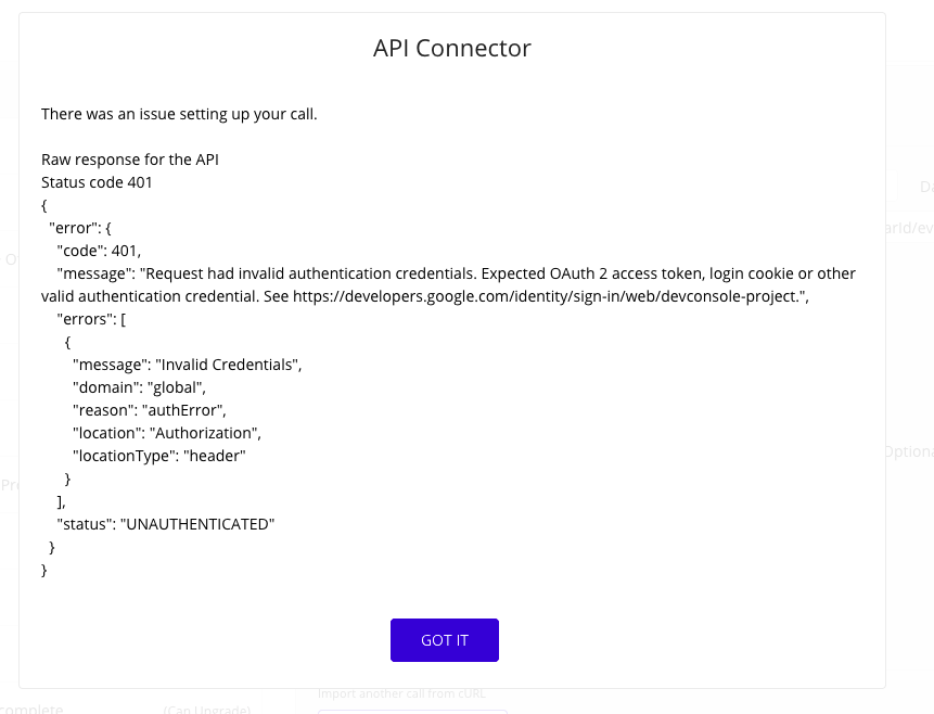

Hello, I am trying to get authentication for the Google Calendar, but I am stuck. I have been getting the following error
I have followed these steps:
It would be greatly appreciated if you could provide me some guidance! @Noqode do you have any suggestions?
Thank you so much in advance for your time!

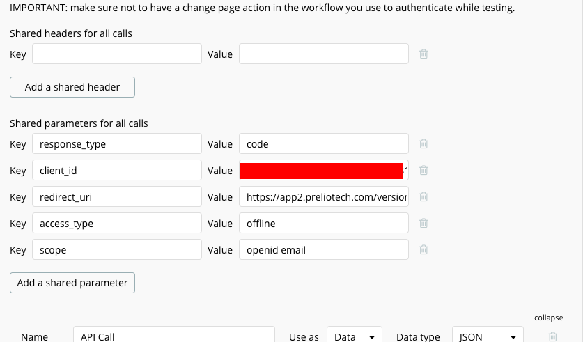

this is my setup
and all I get back are userid’s and their corresponding email’s. i can also call any endpoint i want.
the issue is that the token doesn’t always automagically refresh and I end up getting this error
The service FullCalendar's - Read Google Calendar Events  just returned an error (HTTP 401). Please contact the plugin author directly for feedback. Raw error:
      "error": {
        "code": 401,
        "message": "Request had invalid authentication credentials. Expected OAuth 2 access token, login cookie or other valid authentication credential. See https://developers.google.com/identity/sign-in/web/devconsole-project.",
        "errors": [
            "message": "Invalid Credentials",
            "domain": "global",
            "reason": "authError",
            "location": "Authorization",
            "locationType": "header"
        "status": "UNAUTHENTICATED"
the only thing I can think is that I log in too many times and run out of refresh tokens which causes the error. there is an upper limit to how many can be issued without error.
any insights here?

I am using a self-handled flow, which in itself is pretty confusing. If you follow the above steps to a t, I promise it’ll work!
Thank you for sharing. I suppose I can update us a little bit further. It seems like I run into the most issues with authentication when I log into the same page over and over and over. I can’t seem to figure it out for now. I may switch out to a south handled flow but that doesn’t make for an easy plug in use. Anyway, thanks for the fill-in and hopefully we can get this figured out. It would just be nice if Bubble would give me access to the token that’s returned anyways instead of only handling it them self
Update
These work for me now. I had to ditch the oauth agent flow and instead hash out refreshing and storing tokens on my own. Well worth it but it was a bit of a B
I understand. Are you reauthenticating on every page? OAuth only needs to authenticate once, and the refresh token needs to update before it expires. If you have an action where you’re authenticating every time, it’s at that point you’ll run into those issues.
