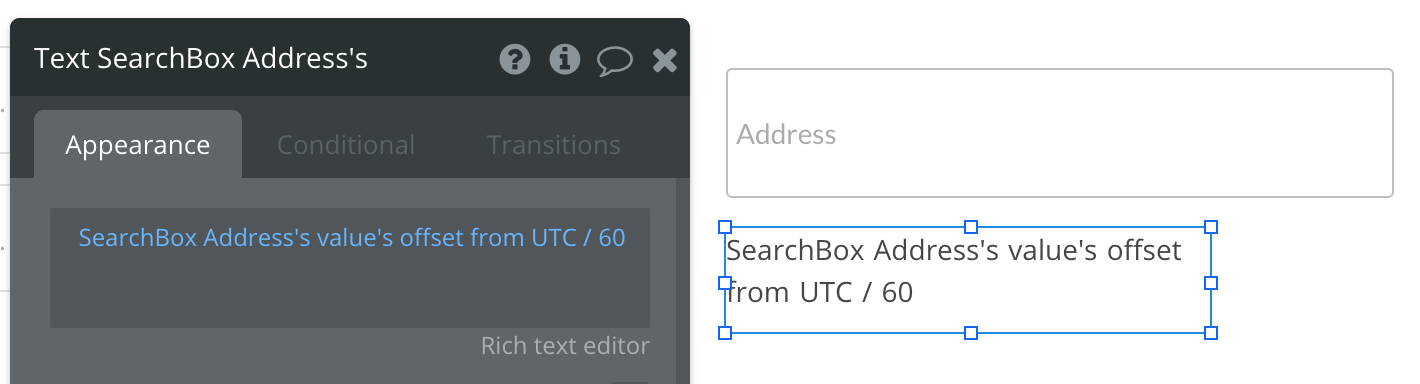

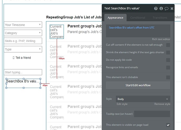

Sure thing! This is the setting I am trying to get working. The output I’m looking for would be something like "UTC+5"

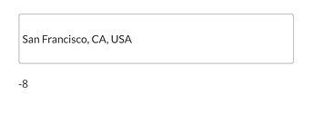

I believe the result that you get is formatted in minutes, so you need to “convert” it to hours by dividing by 60. (Then, manually add in the text for UTC).
Setup
Looks like
