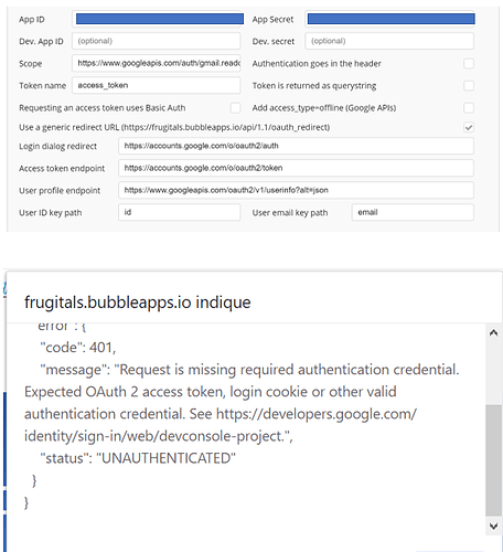

Is there something specific with Google when making a API call using OAuth ?
I can connect to spotify without any problems but it seems not to work with Google/Gmail.
I tried this & got the 401 error message :

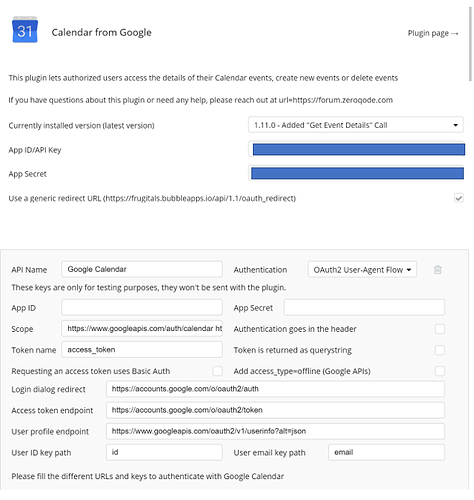

Although, it works very well with the free Calendar Plugin

Arf… I finally solved it :slight_smile: So simple but tricky !
For the ones with the same problem (as I didn’t find the answer anywhere) :
Don’t forget to put the userprofile in the scope you request. If not done, you get the 401 because you’re not authorized to land on the userprofile :
In my case, I added
https://www.googleapis.com/auth/userinfo.profile https://www.googleapis.com/auth/userinfo.email
to the initial scope (https://www.googleapis.com/auth/gmail.readonly)
with between scopes
