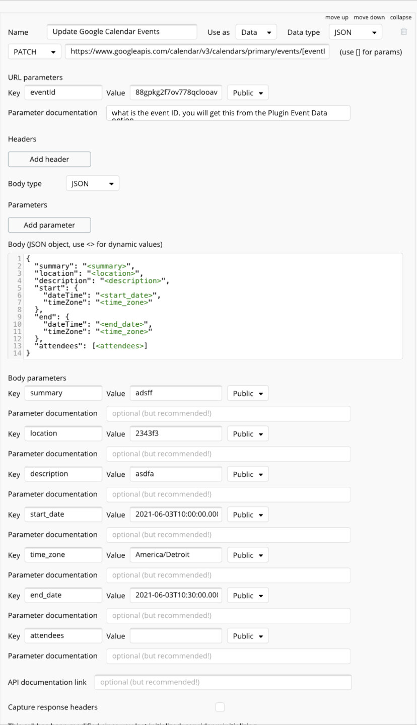

It’s only in the preview and live versions of the app that I can’t do these three actions. Create. Update/patch. Delete
Shots of the api calls for reference
The main setup which works fine
The scope being requested
    https://www.googleapis.com/auth/calendar profile email

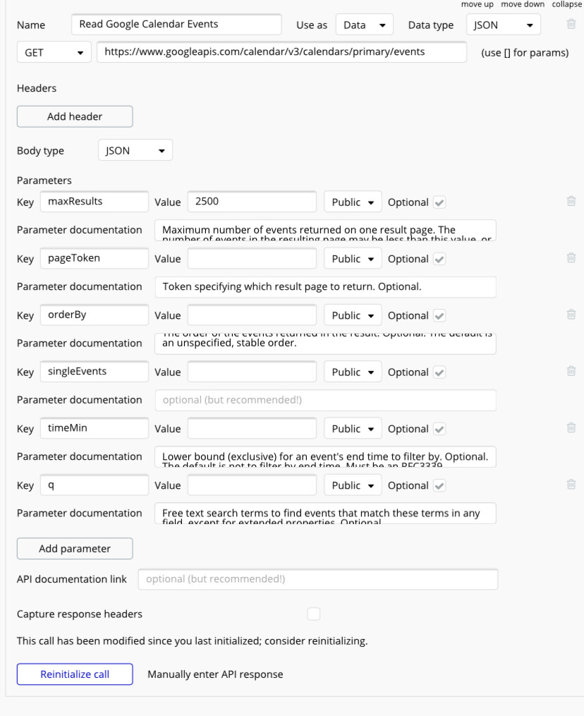

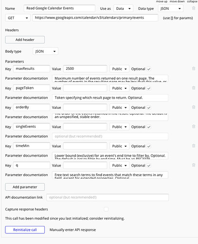

A read (GET) call which works fine

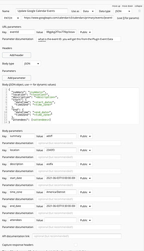

The update call which works fine in the builder but not any live version of the app even after authenticating.

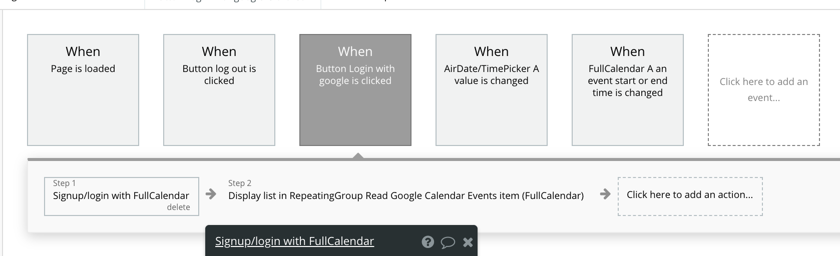

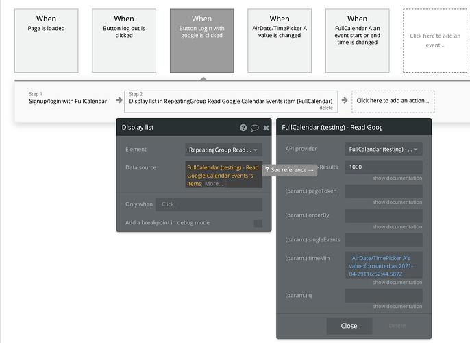

i login and then send a list from the authenticated API call to a RG (this part seems to work fine)
Here is the login WF

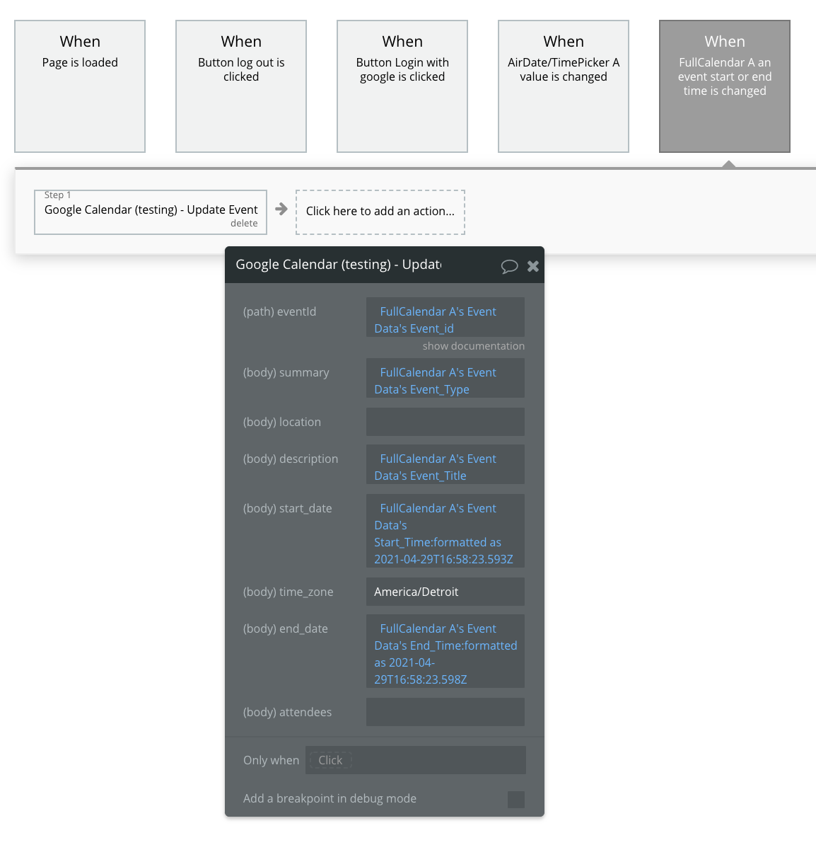

the issue comes when i try to call the update endpoint. what i dont understand is why this part works in the builder but not here.
when i run this workflow in preview (meaning i did authenticate and recieve calendar events for my logged in user) i get this error which is easier to read above
