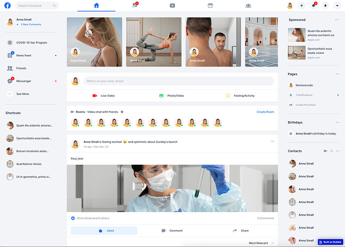

Is this what you mean - here I have numerous repeating groups nested, expanded and responding to all screen sizes from 320-4400px
