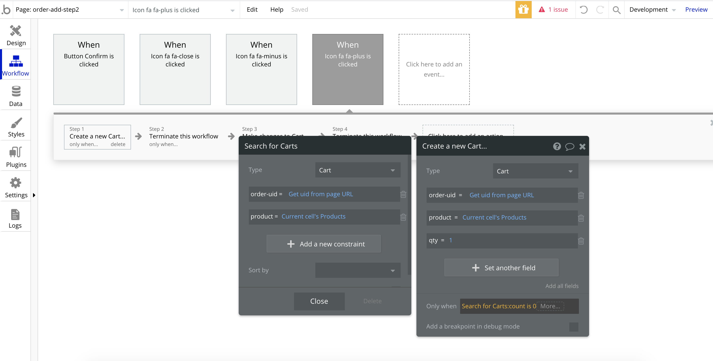

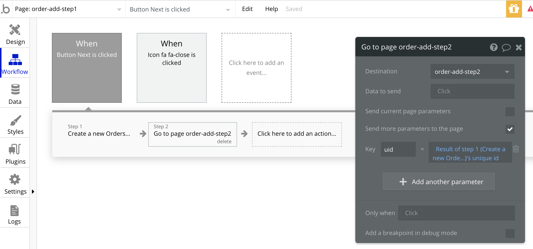

The steps to create a new order is as follow:
  1. Fill in the customer information
  2. Add things to the cart.
In step 1, after next is clicked, I passed the order-id to step 2
Then, in step 2,

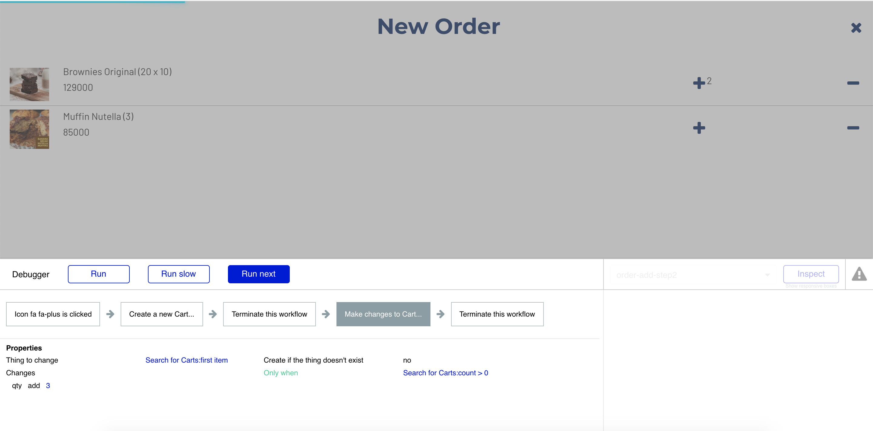

when i click + for the first time, it creates a new cart with the order id and qty = 1

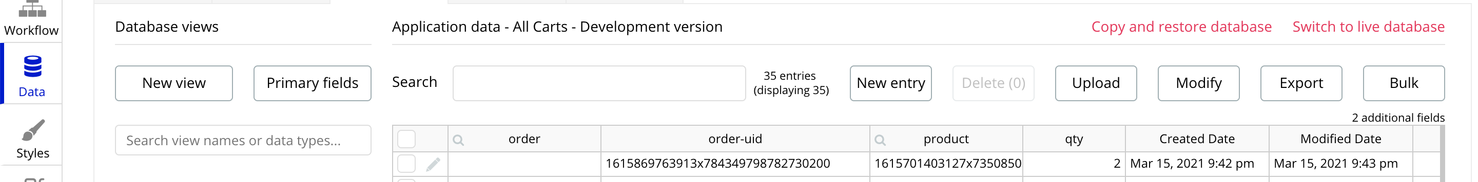

then, when I click + for the second time, instead of adding the qty to become a total of 2, it shows up as a total of 3 in the UI
Although, in the dataset, it is showing correctly as 2
Any insights to fix are greatly appreciated.
