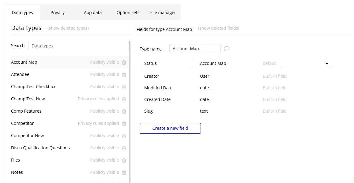

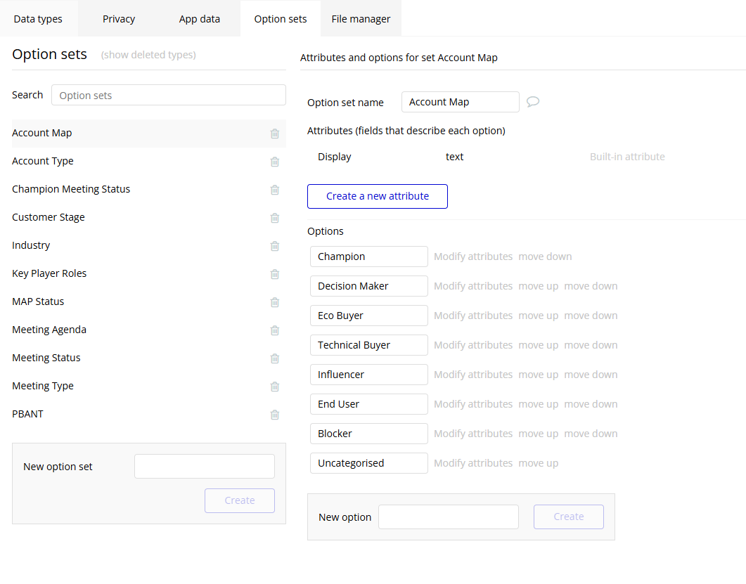

Data Types and Option Sets: All elements on the left hand-side (not yet dragged) are categorised as ‘Uncategorised’. The data type consists of different option sets which correspond with the drop zones.
Once they’re dragged into a certain drop zone I.e., Champion, Decision Maker etc., I want to change the element from ‘Uncategorised’ to the relevant Option (Champion).

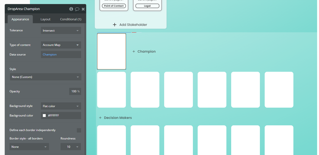

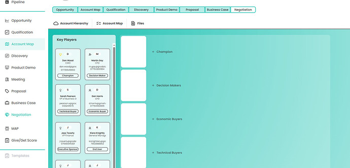

Here is an example of the draggable elements and the drop zones with the data sources.
And finally, the workflow. The workflow seems to add up but when I drag an element into the ‘Champion’ drop zone, nothing happens?
