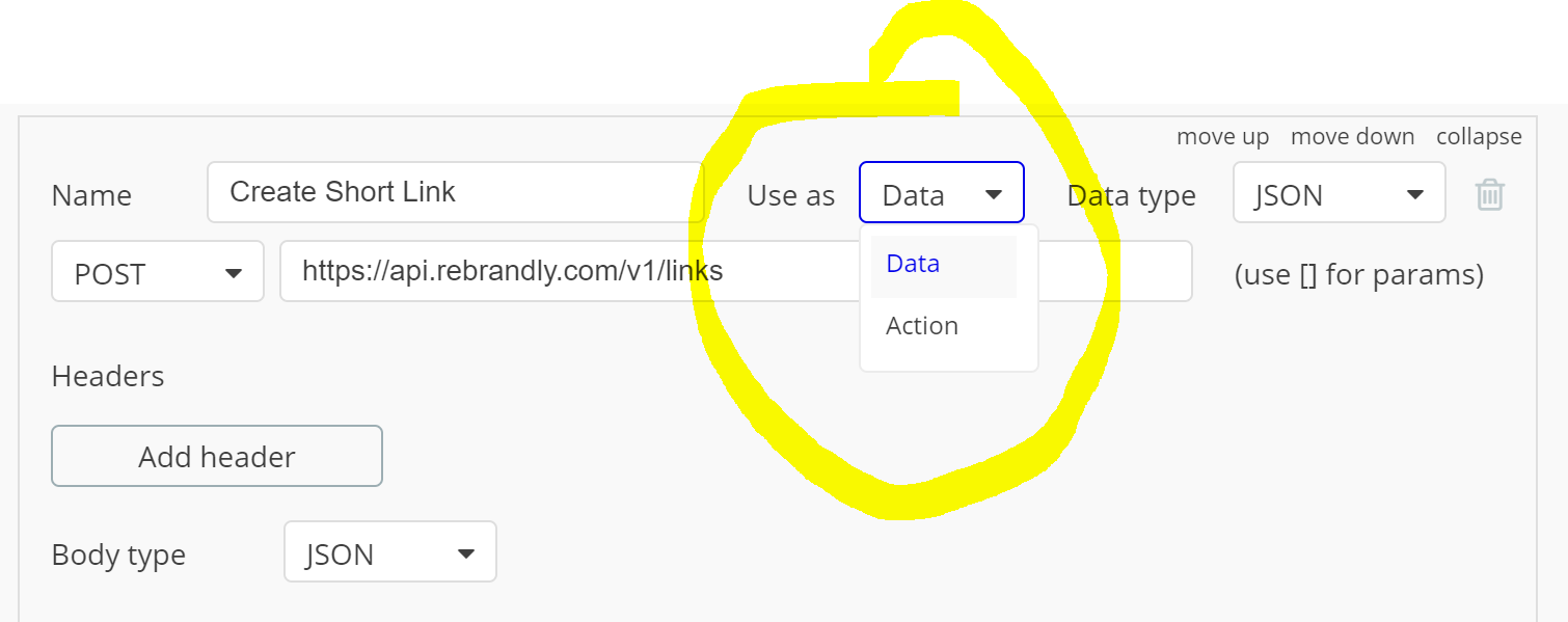

When you configured your call in the API Connector, you set its “Use as” field to either Data or Action (you may not realize that this setting existed, as it defaults to Data!):

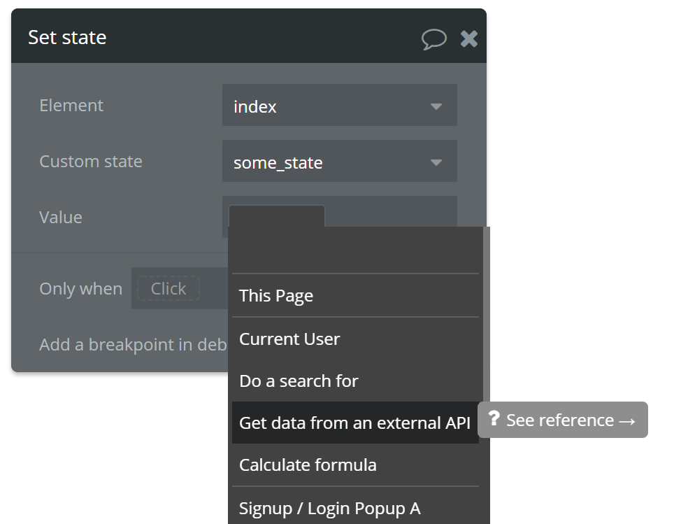

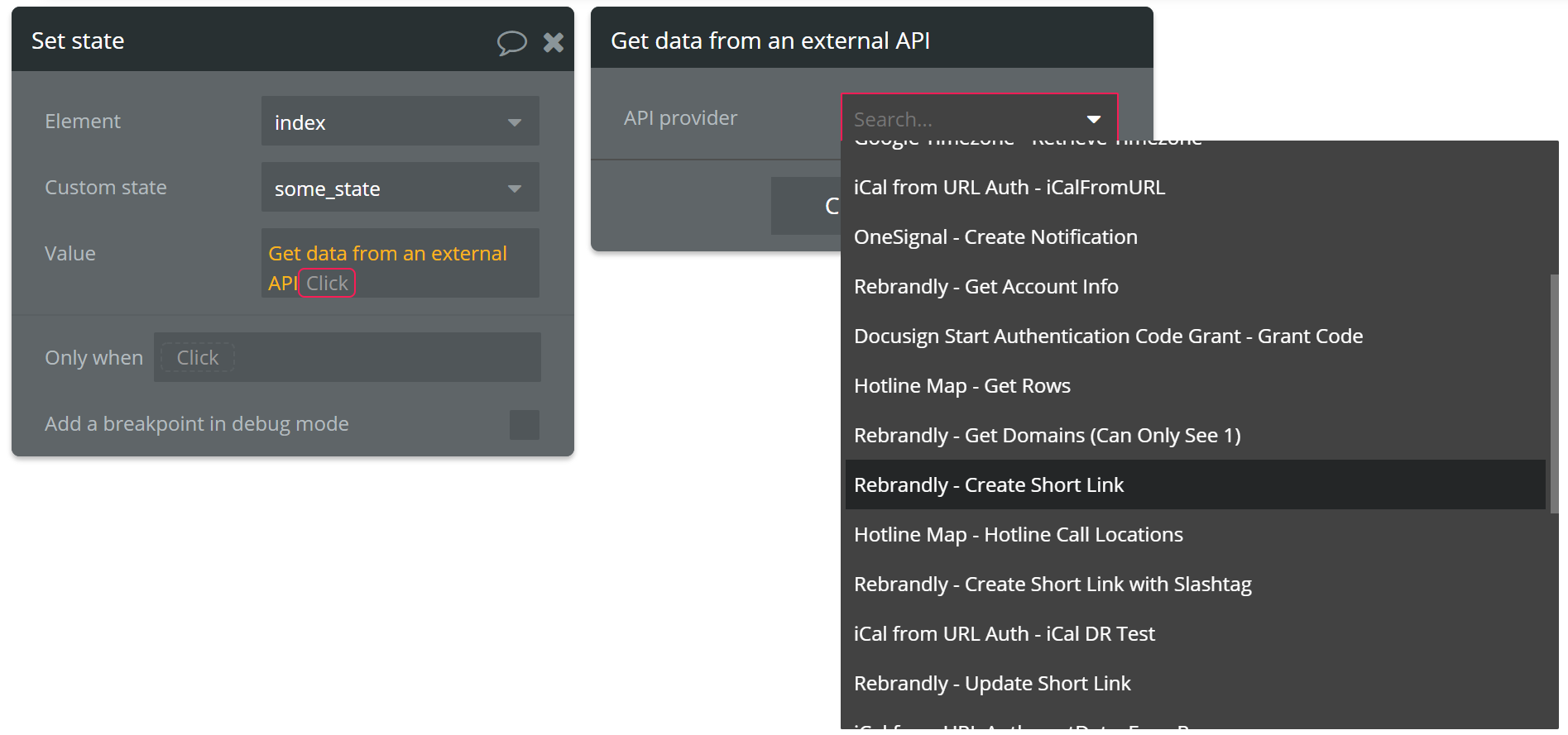

A call that’s configured as a “Data” call will show up as a data source anywhere that you can build an expression (under “Get data from external API…” then select the API call in question).

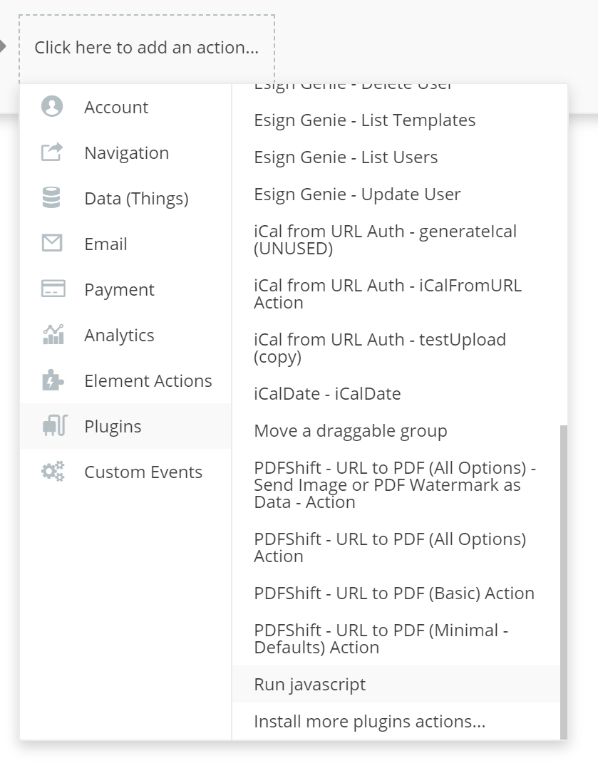

A call that’s configured as an “Action” call will show up in as a workflow action you can assign to a workflow step (find them under “Plugins…”).
If your call exists simply to execute some process, you probably want to configure it as an Action. (Especially if it does not return any data or if you don’t care what data it returns.)
However, it doesn’t really matter either way. If the call is a Data call, you trigger it by requesting its data. If the call is an Action call, you trigger it by a workflow action.
