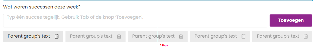

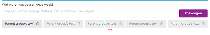

  1. They use a multiline input field to submit a success that gets added to a custom state and gets shown in a repeating group underneath.
    (2. This RG has an delete icon which enables deleting from the RG.)

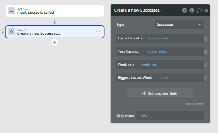

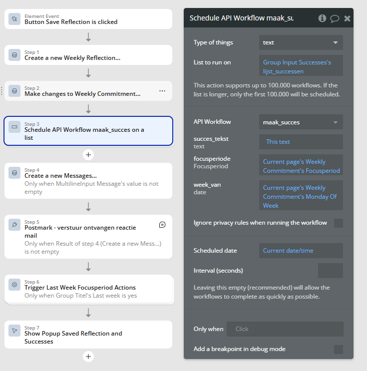

  2. On saving the reflection one of the steps is that an API is called that converts the custom state list of successes to data types success.

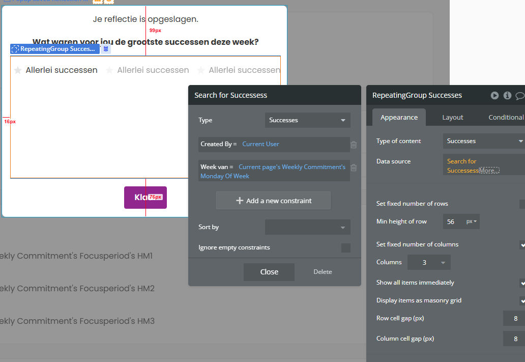

  3. Then a Pop-up is shown in which all the success with the same number (not calculated from time but written to the data-type as a number) are shown in a RG and the user can select the biggest success.

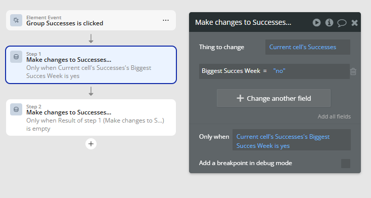

  4. When the user selects a success as the biggest success (or deselect) the relevant data success ID is adjusted.

  1. The loading of the pop-up is a bit slow.
  2. I’ve gotten two messages from users who couldn’t select their biggest successes (other users were fine, and before it worked as well).
