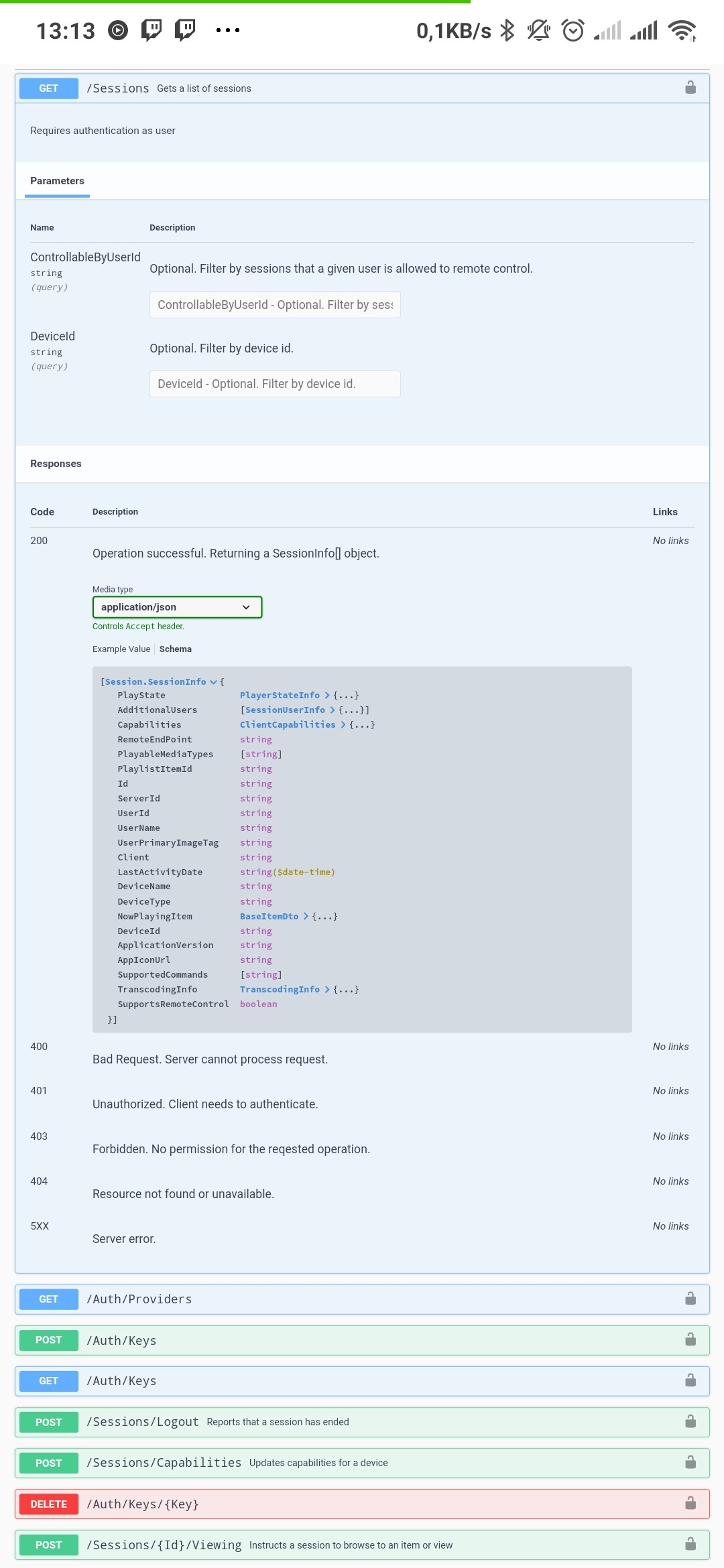

the error is right in front of me I know! but I can’t solve it, I’ve already looked at the api documentation and I believe I’m doing it correctly, but even so when I make a GET call I always have this error. the attached images are of the error and the fields that contain
unfortunately I don’t know what’s missing! I’ve added more header and nothing. in postman just the url of the call is enough. please help me with some suggestions

http://IP:port/emby/Sessions?api_key=keyapi
