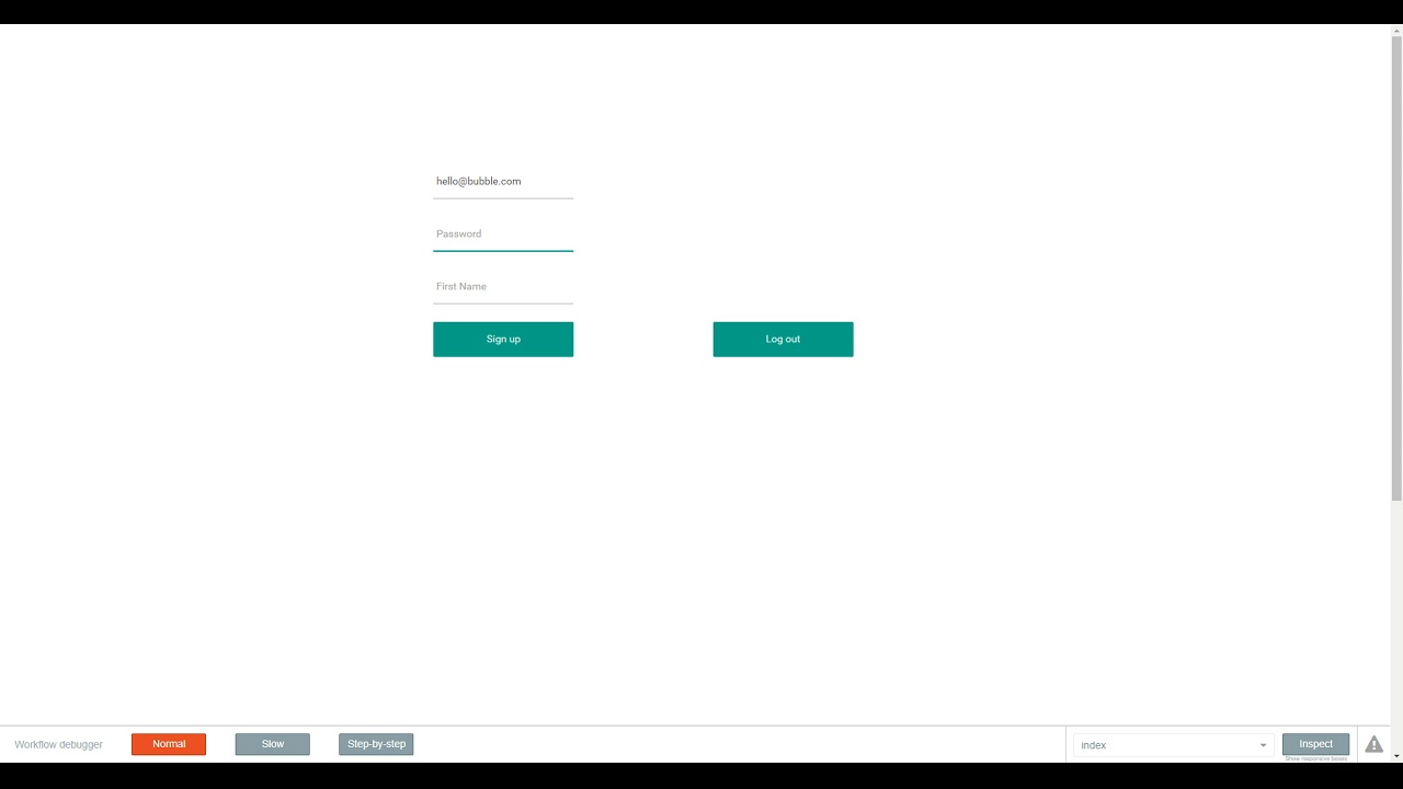

For this specific example, it’s usually best to put roles in the User table, then use "Only when User role is “Admin” and permissions to enforce role privileges.
That said, to answer your question on linking tables: Create a field in a table with the linked table as the type.
So let’s say Manager has its own table. Thing is Manager. Field 1 = First name, type text. Field 2 = User, type User
You can then call in dynamic information like “Current User’s Manager’s First name” or “Search for…”
I’ve created a basic example here, but as it’s temporary I’ll include screenshots as well. If you look at the Data tab you can see I’ve made two tables. Note that when displaying data in tables separate from “Current User” you’ll need to add constraints.

Wow, thank you!! Makes perfect sense when you see it like that. I was over thinking it. The reason I was going to put the user types in separate tables was because I am building a saas / multi-tenant , but I can see I may be making it over complicated. Will play around with these options now I know how it fits together. Thank you.
