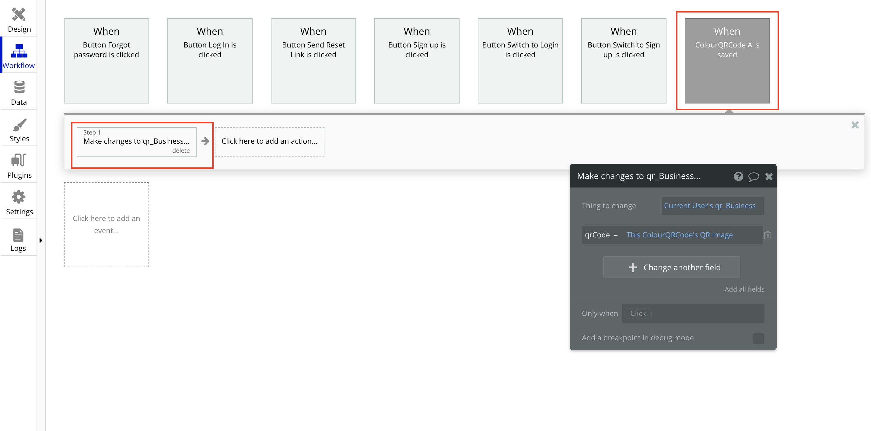

If my memory is correct, I think there is another workflow that says something like, when a QR code image is saved. Not a step, but a workflow. Can you try clicking on add another workflow and see if there is an option that says something like, ‘When a QR code image was created’ or something like that?
I don’t think you can save it from within the same workflow because it takes a few seconds for it to generate. Your saving to the current user is probably blank right? I can try to take a screenshot for you in a few hours, but I think there is a separate workflow that you need to do the saving to your database in.
Will try to post a screenshot for you soon.
@b.goldsworthy01 Here it is, so click ‘Click here to add an event’ to add another workflow called ‘ColourQRCode A is saved’ then save the QR code in this workflow.
Thank you so so much @j805 it worked like a charm.

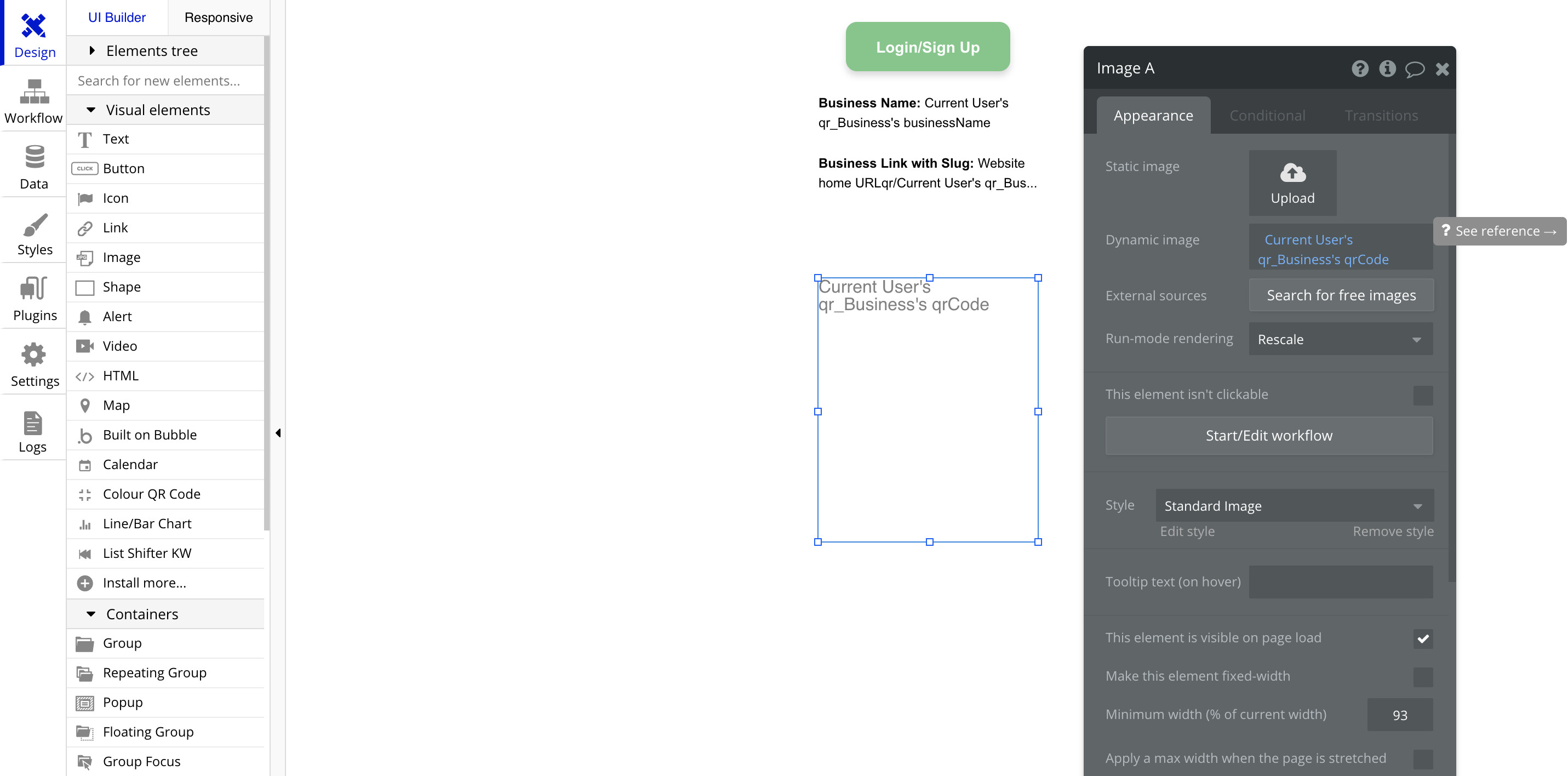

Here is how you could set up your database. We might add more to it later, but this is a good start.
Add another field in the database called qrCode this will be an image type.
Step 2 - Make sure that the user has a business attached to them when they sign up. I just created a random name and attached it to the business for testing purposes.
This way, when the business creates a QR code, you can attach the QR code link to the business and user.
Step 3 - Set the business’s slug:
Step 4 - Generate QR Code
Step 5 - Save the QR Code to the Business
Step 6 - Display the QR Code to be scanned by the user
Step 7 - Go to the new page that it takes you to (I called mine qr)
Step 8 - Display results, here is how you would show your business their details of all the scans. Or you can email some results.

done but I can’t understand why its all done before sign up. I need all the info attached to the qr code after sign up. which is created inside the users account which is the business. the business/user already has a slug attached to them. So would I attach all above info to the qr generated inside the admin page? and add all the data to the user inside my database? I imagine step 8 is what i’m after. already a user/business can log in and create the qr code wich is displayed on a promotions page by way of that user/business slug. or do I still need to follow all the above steps to achieve this. and thank you so much for your detailed information.
The qr scan code isn’t to take a user to the business web page. Its used for promotions so the qr code may be change at will by the user/business and that could be daily, weekly etc. hence needing to have the detailed information stored for that user/business, so they can keep track of how it’s being used.
Another important bit of information I need to show is how many times the code has been scanned? that is actually the most important thing to track. The user/business is paying per scan that takes place.
if you would like to look at the web app for reference please just ask. I have learned a lot off you so far to do with QR codes. I appreciate your time and help.
Yeah. Of course! Mine was just an example. You can put it where ever you would like. :blush: I just made mine as simple as possible.
Good job! Glad you got it working. Now you just need to adapt it to your needs. :+1:
