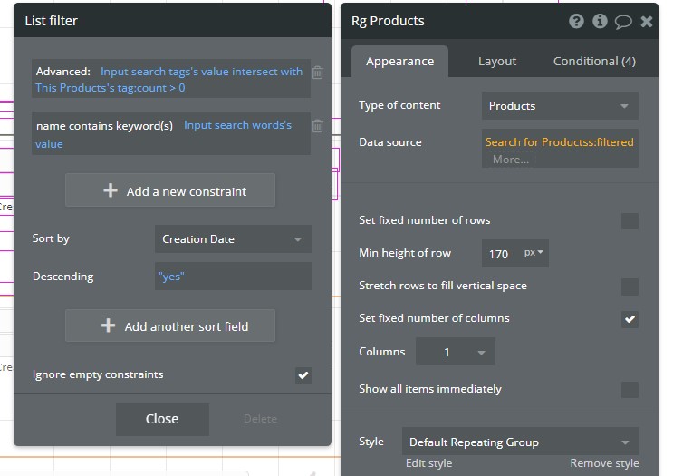

I have a text search bar and a multidrop down search bar. The Repeating Group shows results only when I fill in the multi drop down entries but not the text dropdown. However, once I have filled in the multidrop down, then the text drop down works and I get the correct results. But by itself I get no results when I enter a value in the keyword drop down.
I am doing a search that looks like this
in Pic 3 in the filtered list part.
In the regular part, I have

Actually, if I remember correctly, ignore empty constraints doesn’t work with advanced filters, and I just confirmed that with an example on my end.
So, I believe the way to go here (which I have also confirmed with my example) is to remove the filter on the repeating group’s data source but keep the name constraint on the search with ignore empty constraints checked. Then, add a condition to the repeating group that says when the search tags input’s value count is greater than 0, change the data source to the search (which should still have the name constraint with ignore empty constraints checked) with the advanced filter applied.

Now for the repeating group’s settings. The main data source (on the Appearance tab) should look like this.
Then, there are five conditions on the repeating group, and they look like this.
The first condition’s data source looks like this.
The second condition’s data source is the same as the first, except the sort’s Descending field is set to “no”.
The third condition’s data source looks like this.
The fourth condition’s data source is the same as the third’s, except the filter has the sort settings in place.
Finally, the fifth condition’s data source is the same as the fourth’s, except the sort’s Descending field is set to “no”.
