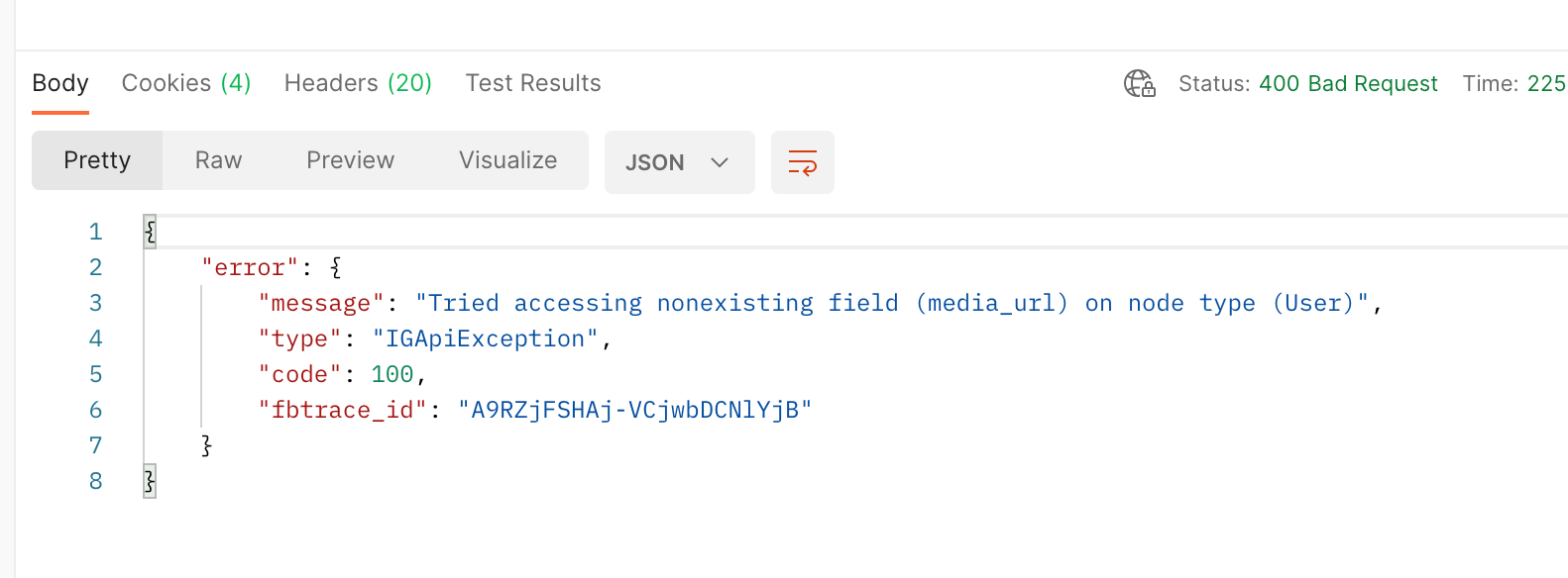

And when I try calling an API on Postman I get this:

On Postman, though, using this GET request I can see my posts:
https://graph.instagram.com/me/media?fields=id,caption,media_url,permalink&access_token=IGQV
Any idea what I could be doing wrong?

About a year ago, Instagram deprecated the Basic Graph API and introduced the Instagram Publishing API. Going forward you’ll need to use that instead of the basic one.
If you want to get posts for a user, look at this: IG User - Instagram Platform - Documentation - Facebook for Developers with the /media endpoint.
Here is an announcement we did way-back-when that might give further help.
