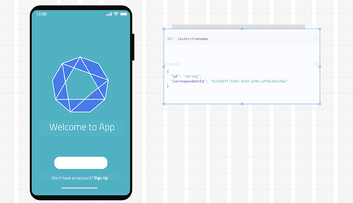

Im trying to demonstrate request and response JSON data from an External API call.
Essentially I want a button click to make the API call and just show the RAW data (Pretty Print) on a Textbox or HTML box (or any element that can do it). I cannot figure out how to make this work, even tried some plugins.

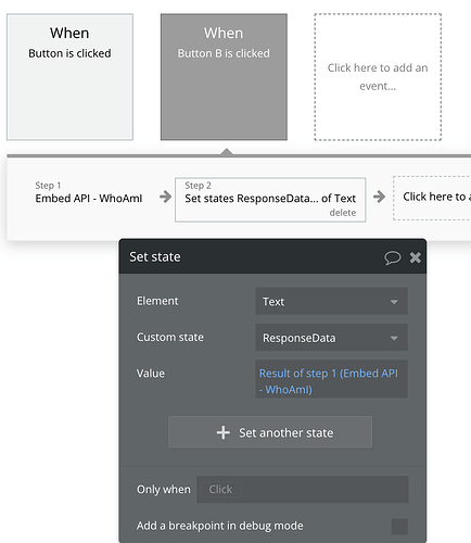

Use Api-connector plugin to configure your 3rd party URL and get the response (Data Type is Action).
Add new button element on bubble page, from thie workflowaction add above action to get response and save as custom state.
Use above custom state to show into textbox or html element.
I really appreciate your response. I cant seem to get it to display inside the HTML or Textbox.

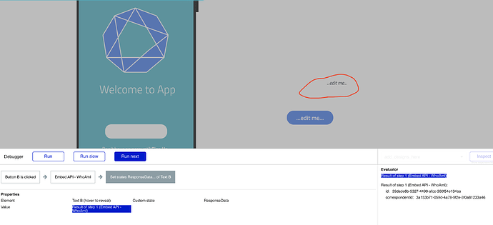

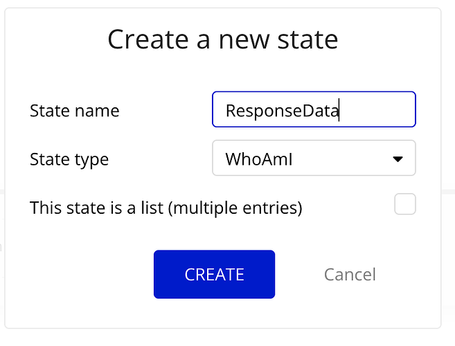

Any feedback on what I may be doing wrong? Heres a screen shot of the flow. The data looks correct I set the API to return Action, created new state to return value of EmbedApi-WhoAmI
