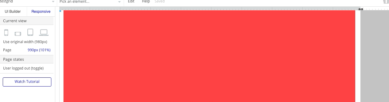

I set up a quick example to show what I mean. Note the pixels/percentages on the left side and how the “row dumping” occurs at 980px, 100% width:
