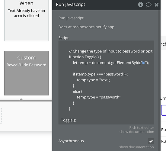

You can always just use a piece of javascript code instead, this is using the Toolbox plugin’s “Run Javascript” action that is triggerd from a custom event I created, with the “id” being the unique ID of the password input. It toggles the type of input from a standard text input to a password input and vice-versa.
// Change the type of input to password or text
    function Toggle() {
        let temp = document.getElementById("id");
        if (temp.type === "password") {
            temp.type = "text";
        else {
            temp.type = "password";
Toggle();
