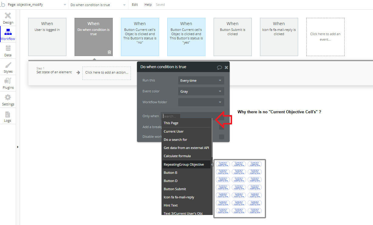

I’ve been using bubble for some days and I currently encounter a problem and didnt found a solution.
I’m currently building an app where users can “pick” terms from a list (it’s a kind of dating app, so terms are like : romantic, calm, lover…).
I have the following problem :
On Onboarding Pages, users can pick terms freely (and their choice is highlighted with a “set state” = selected, so users knows what they clicked on it.
BUT
When a user want to “modify” the selected terms from his profile, the cell’s obviously doesnt remember user’s choices when on onboarding.
Therefore, I would like to do the following:
When a user wants to modify the “terms” I want to highlight the cells that match the terms he got in his Database.
So If i choose “Lover, Calm” from the Onboarding, I would like to have those terms “Highlighted” when I come back on this page via “Modify”
I tried something like : “When Current Cell’s Loving Term is Current User Loving Term” THEN => Set State to “Highlight”
But I can’t success to have a working conditionnal on this, because “When Current Cell’s Loving Term is Current User Loving Term” doesnt seem to work.
I am using a RG to Display a List of Loving Terms (using a button)

Yes I know how to use custom states, the thing is it doesnt let me end the “Conditionnal Action”.
I mean, I didnt found any way to have “When Current Cell’s Loving Term is Current User Loving Term” in blue (it means it work) It always red, no matter which side I choose to make this action happen.
I tried from the Button’s Condition itself, and from the workflow page, like this "Do When this is True ; When Current Cell’s Loving Term is Current User Loving Term, then set state to “Selected” and state selected is “Blue Color”.)
I mean, is there anyway to have someting like that : When Current Cell’s Loving Term = Current User Loving Term, set state of Current Cell’s Loving Term to Selected.
And also, I do not understand why I can’t use the “Current Cell” when I select “Do when condition is true”
