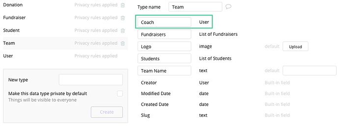

Here’s the table structure:

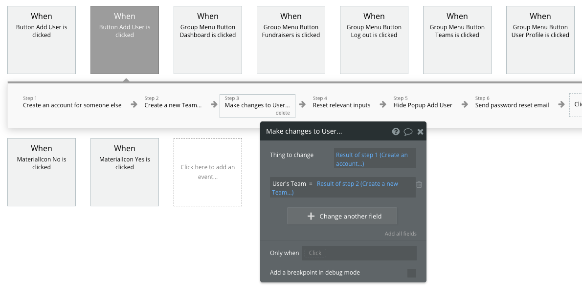

Here’s my current workflow:

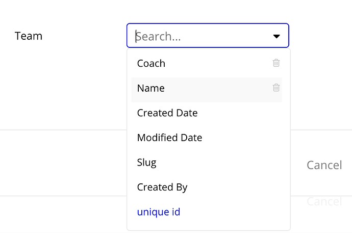

When you click pen icon when looking at User table in the App data tab, you should see “Change search field” text. Just click it, and then change this field to “name”.

Thanks, @alanpieczonka! The good news is that I can search by the different teams using the method you outlined, but oddly enough, I don’t see a value in that field (it shows an empty field) unless I add it manually. Perhaps there’s an issue with how my workflow is set up?

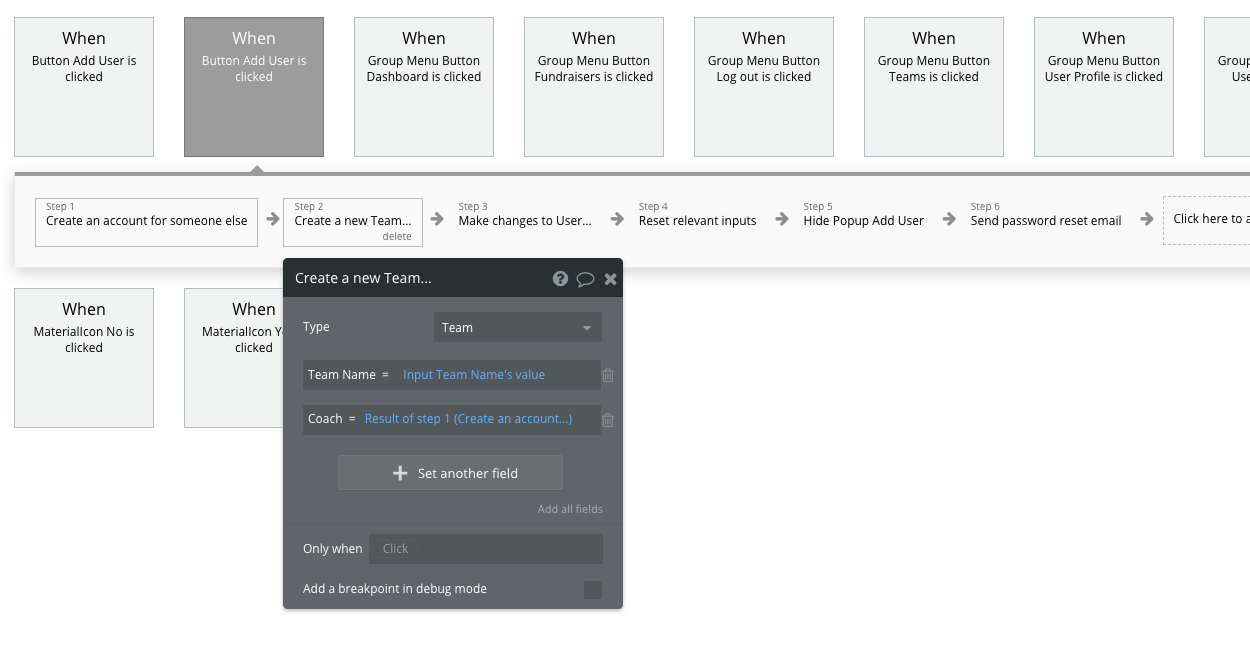

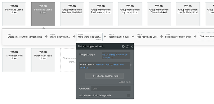

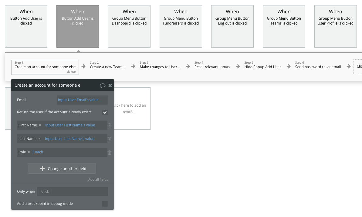

@alanpieczonka Answers below!
  1. That is correct. Here are a few screenshots of the first three steps of the workflow:
