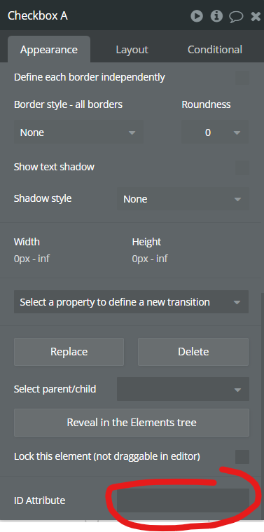

Option 1: Custom CSS
Insert the Following CSS in an HTML Element:
set the following ID “myCheckbox” on the Checkbox
/* Default (unchecked) checkbox style */ #myCheckbox input[type="checkbox"] { appearance: none; -webkit-appearance: none; width: 20px; height: 20px; border: 2px solid red; /* Red border */ background-color: white; /* White background */ border-radius: 4px; cursor: pointer; display: inline-block; position: relative; } /* When checkbox is checked */ #myCheckbox input[type="checkbox"]:checked { background-color: red !important; /* Red background when checked */ border: 2px solid red !important; /* Ensure border stays red */ }
