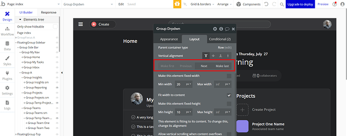

I am trying to make a clone of Asana, on the 'My Tasks" tab there’s a feature they have on some of the columns that I will like to to recreate. I have attached a screenshot
When “move right” is clicked, “Task Visibilty” and “Due Date” swap positions. Can I do that with Bubble? It acts very much like the new alignment settings on Bubble (see second screenshot)

To do this, you just need to change the ‘order’ property of the element…
Bubble doesn’t give access to that in the editor, so you’ll need to use some custom CSS, but you can just use a custom state (or group data variable) to set the order property.
Hi @adamhholmes thanks for contributing. What is the order property? How can I change it with custom states?
The ‘order’ property is a flexbox CSS property that defines the order (position) of an element within its parent container (in this case a row).
you can change it with a dynamic expression in some custom CSS (as it’s not a property Bubble gives us conditional control of in the editor).
Here’s a simple example of how you might do it (this doesn’t use custom states, but rather Group Data - but the concept is the same)
Change Row Order (bubbleapps.io)
@adamhholmes thank you! I understand what you mean now. That was helpful.
Here, do you mean I achieve the same thing with custom states alone? (no css or javascript needed?)
I mean just use a custom state instead of Group data (it really makes no difference).
okay, thanks @adamhholmes
