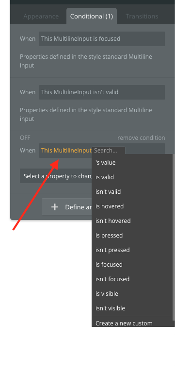

The only other way, which isn’t practical is to create a condition where you can get the element’s type in the condition:
Thanks, @julienallard1.
I appreciate the tip of using a conditional to pick up the element type. It is probably all I need for my purposes.
