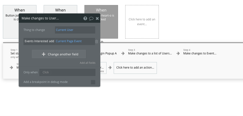

Should I create a new thing? to get the workflow to do this? Below are two screenshots in what I’m trying to do , a bit stuck here if its the right way to do it. Also not sure why
In the last screenshot (below), in the workflow, I’m trying to save/add events that the user is interested in / (or alternatively is attending). Why does it not accept the field current user’s events interested, what should I add further?
Could you please suggest? Thank you!

Hi @andrewgassen, thank you for your reply.
What I am actually trying to do is as follows:
Database Side:
  1. Events as data type has a field ‘event attendees’ (field type for the field is list of users)
  2. Users as data type has a field ‘events to be attended’ (field type is list of events)
UI
I want to , with a click of a button, allow user to register for an event.
What should be the workflow to allow:
  1. A user to save an event
    (Field name events interested, as in the screenshot)
  2. A user to register for an event
  3. An event to receive the list of users, so an organizer can see who is joining.
Question:
a) So I tried the steps you explained above, I wonder if it’s right? I think it is right for changing a field. Screenshot attached
b) However how to implement change to a list of things? This is somehow still showing in red colour/issues in the workflow. Screenshot Attached
For changes to a thing → Event → Field to change Attendees → Add ‘current user’ . Is it right?
I think I’m almost there. Could you please suggest? Thank you!
