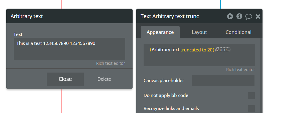

Additionally you can a limit the number of characters using operators:
Result:

That means it needs to be truncated to a set amount of charachters if I’m right? And that is not what I want, I need it to work in a responsive way with a max width of 20% so to say.
