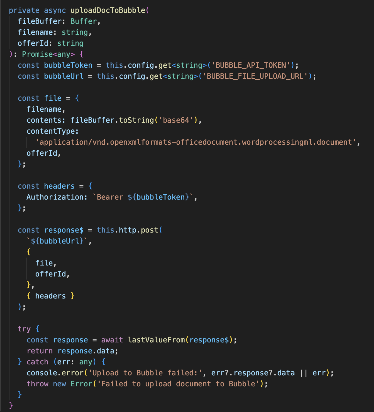

I have an external service that I am using to POST a base64 encoded file to bubble. I want the file to be saved in Bubble storage and I want to be able to attach the file to a Thing so I can make it private. I am currently able to upload a file to bubble using a backend workflow but the file does not get attached to a Thing and it is not private. Also, the url for the file also gets saved as a cdn url as opposed to my domains url which is different compared to when i save a file through my application.
Here is the backend workflow that i have setup
And here is the method I am using to POST the file to the backend workflow
Has anyone been able to successfully upload a file from an external service and make it private?

However, I think you should initialize the backend workflow to receive data from the external API.
You have an url, not a base64 encoded file. This is not the same thing and Bubble expect a specific json object to accept it.
Thank you! I was using a payload that I had seen in another forum post. I should’ve checked the docs first…
