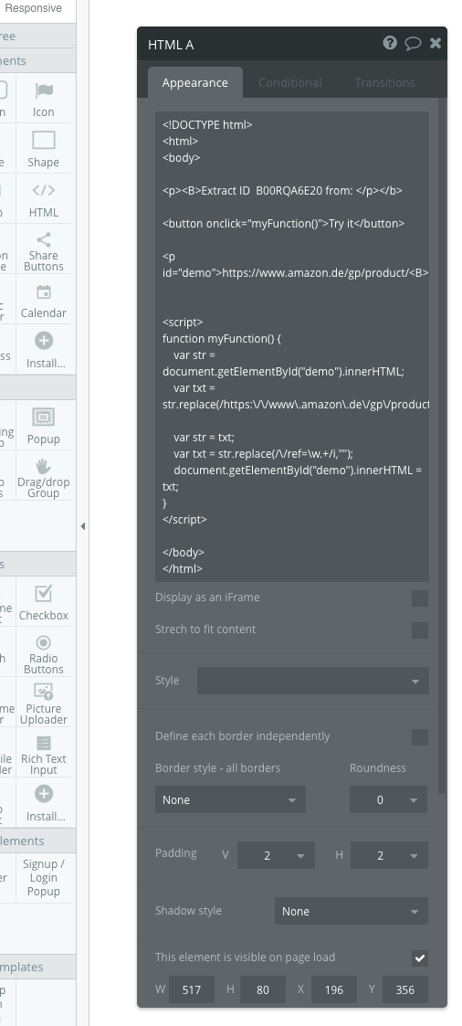

I created an example to extract the ID. Yes you can use REGEX but need a base in JavaScript, and using the HTML icon, and pass variables, or use the other option you mentioned.
demo:
https://public-sharing-apps-nocritital-info.bubbleapps.io/version-test/index?debug_mode=true
workflow:
https://bubble.io/page?name=index&id=public-sharing-apps-nocritital-info&tab=tabs-1
Before:
After >>:

I played with the demo and the app a bit. My only problem now would be: How do I get the extracted ID (B00RQA6E20) “out” of the HTML? SO I can use it in a workflow?
If i’m correct, send data to API Connector. I used API Connector to received info from outside world, and working fine (using the software PostMan before to validated the API Connector response). Writing code in JavaScript to communicate with Bubble API Connector is the challenge. Send me the code when done :slight_smile:
