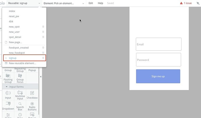

I have a screen with a button (see screenshot 1), which is supposed to show a signup popup element, called “signup” (see screenshot 3)

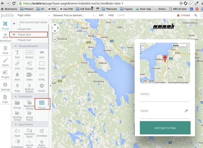

I cannot add a workflow that shows the popup element “signup” since I cannot access the popup element since its not to be found in the dropdown when I am adding SET A STATE (see screenshot 2).
so I dont understand how I can add any logic to make the popup show upon pressing the button.

So I found a way to display an element upon a button press:
Instead of using a REUSABLE ELEMENT, I used a POPUP element from the toolbox.
this POPUP element now shows up in the HIDE/SHOW dropdown via the ELEMENT ACTION panel of the workflow dialog. (I ticked the HIDE ELEMENT checbox and then show the element upon pressing the button via workflow)
