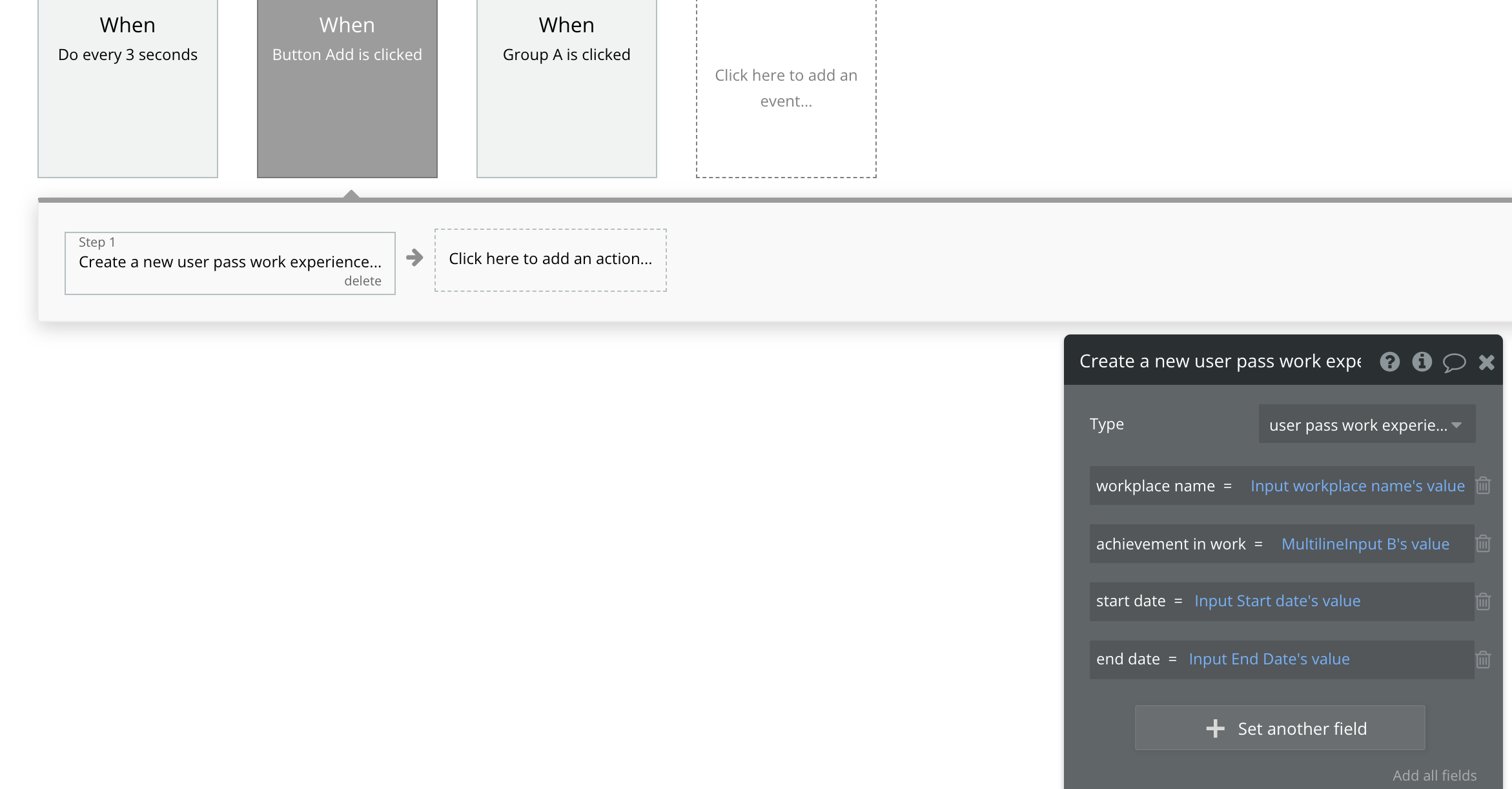

Hi there, thanks for the response, I have tried this, however, 2 problem I am facing here right now is
  1. it doesn’t show on the page if I don’t have any data, therefore the user cannot add their experience,
2 problem is that when the user click add now they have this work experience recorded what if they want to add more, hows should I do this? Thanks!
It doesn’t look like your repeating group has a data source. As I mentioned in my first reply, I assume it should be a search for user experiences with a constraint of Created by = Current User.
It seems like you are talking about two different things now. You initially mentioned a plus icon, and now you are showing an add button. With the suggestion I made, there is no need for the user to click an add button to add the experience because a thing was already created for that experience when the plus icon was clicked.
Oh ok, let me try this again, my bad I didn’t quite get your first message.
No worries… the concept should be pretty easy to implement. Put a plus icon or an add button outside of the repeating group, and when the icon/button is clicked, create a new thing in the User Experience data type.
