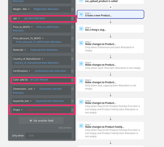

  • I’m uploading a CSV, with the data structured as either text or numbers. For Shape this would be text for ‘Circle’, ‘Oval’, etc
  • I’m sending a list of data to the workflow and running a recursive workflow. So it will be listed as ‘Circle’, ‘Square’, ‘Circle’, etc
  • For adding plain text (like for ‘upc’ I use ‘upc:item #iteration’) and for adding a list of option sets (like ‘Color’) I use ‘Color add list All Color:filtered’ but for ‘Shape’ (a single option set) I don’t know how to connect the text ‘Circle’ to finding the correct Shape option set to add. I initially thought I could do a search for the Shape Option Set’s Display.

Thats what I was thinking about doing but thought ‘this sounds far too complex to add an Option Set, I must be doing something wrong’….
…apparently not.
You doesn’t say why you are using loop… Schedule API on a list is better. But you may have some reason to use loop. (If you can use Schedule on a list, it’s better because it’s cheaper and faster).
As from your settings the first thing you seem to do wrong is to set the type as text instead of option set directly. If your display is what you provide as a list tonyour backend wf, there’s no reason to not set this directly to OS type
About shape, the issue is that you are sending a list of shape but the field is = … so only one item?
