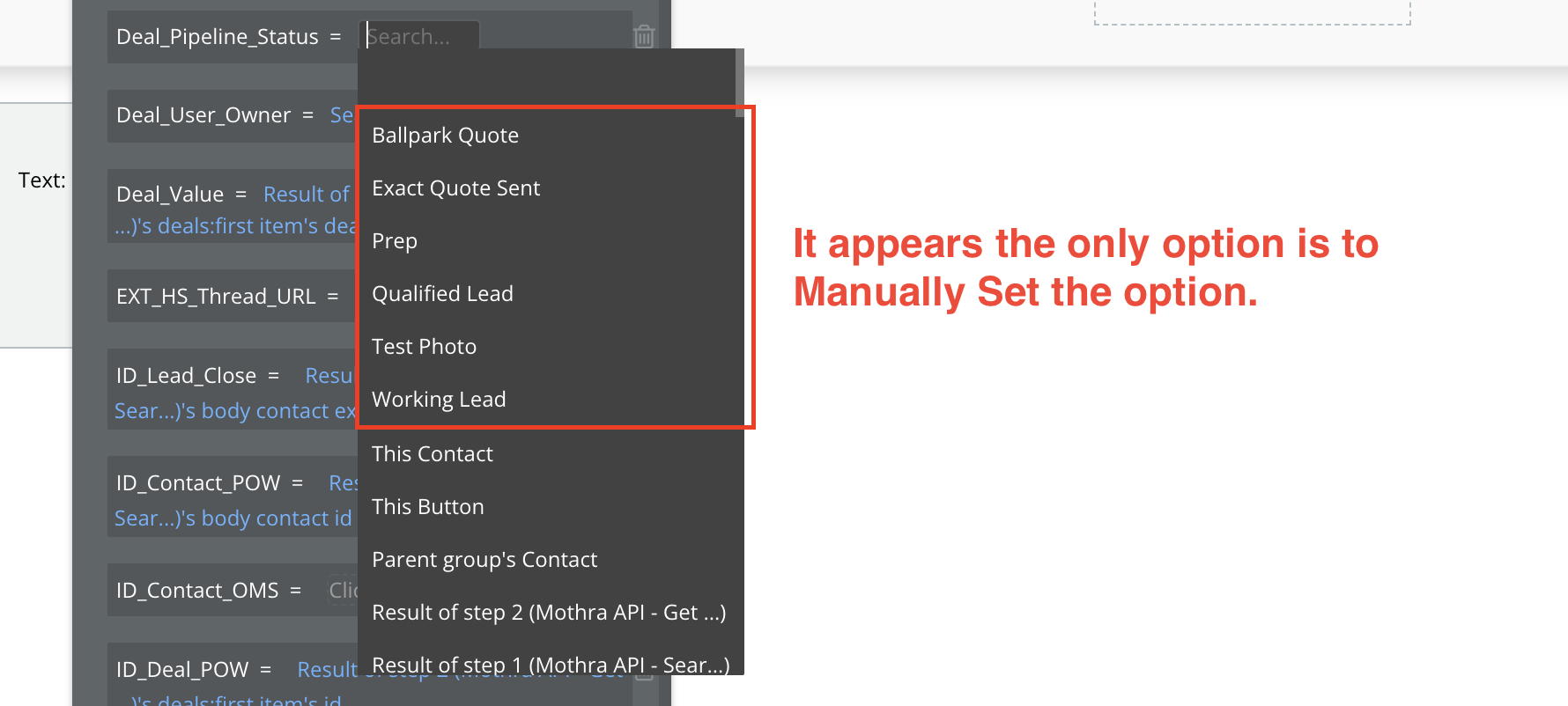

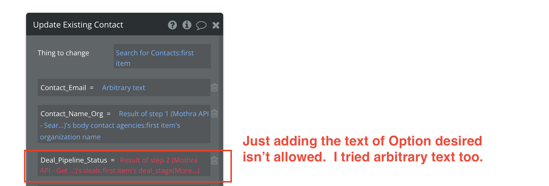

I cannot figure out how to map a specific option from an option set when updating a thing.
I have a data type that is designed to be a dropdown with a fixed set of options. This data type is created from an Options Set “Deal Pipeline Status Options”.
I perform an API call that pulls the “Deal Pipeline Status” from another software and I want to update a corresponding Thing with this corresponding Option Set option. If it’s “Qualified Lead” in the payload, I want to update the Thing’s “Deal Pipeline Status” data to the “Qualified Lead” option.
Can someone please provide some guidance on how to do this. I feel like this should be easy, but I’m totally stuck.

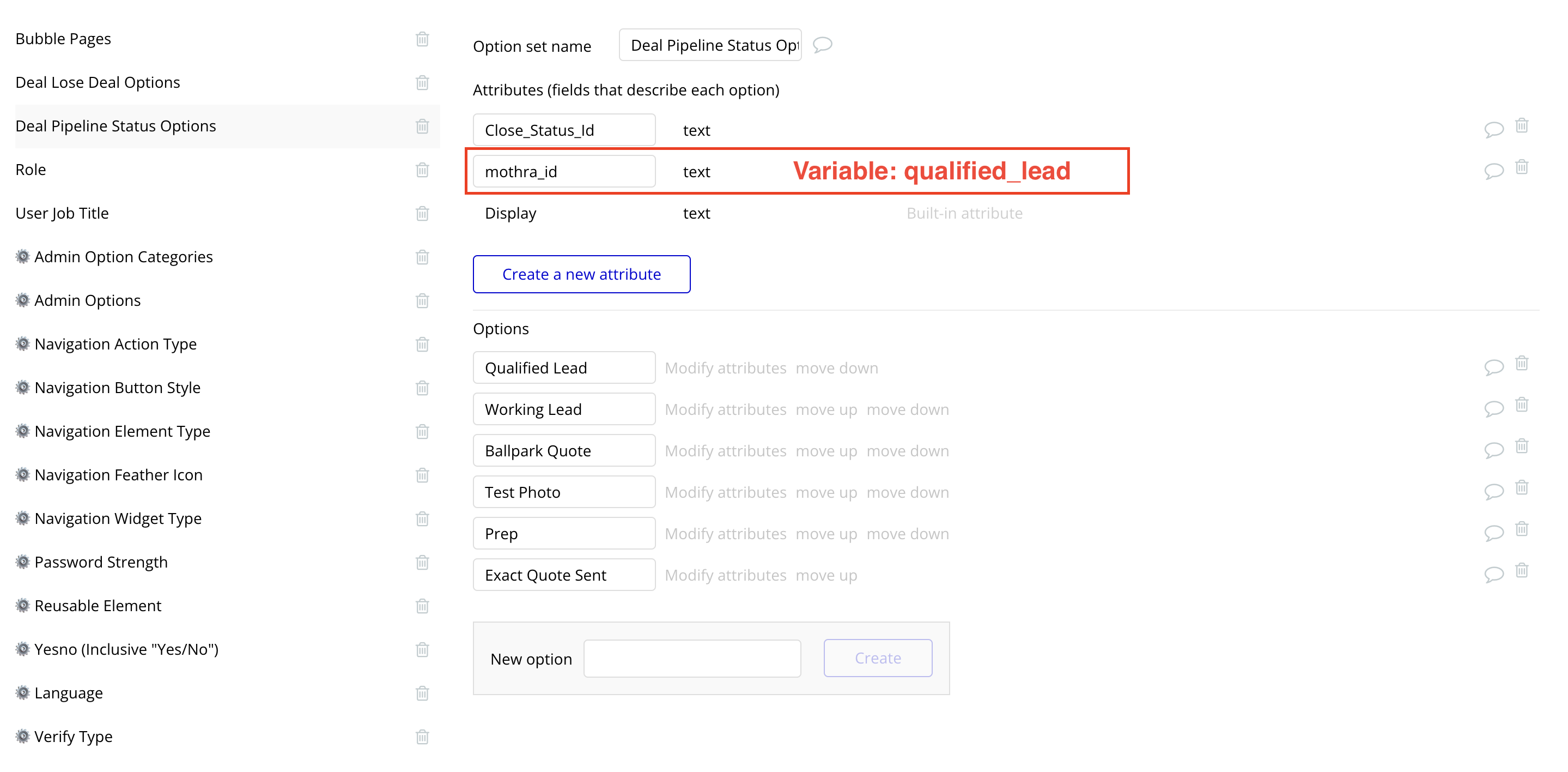

For anyone else trying to figure out how to set an Option Set option, this is what I figured out.
Adam: “Get An Option > All Options > Filtered > First Item”
For The Filter: Create a constraint to match your search variable. It must match to find it. In this situation we were trying to match The Option Set Display which was “Qualified Lead” but the match variable was “qualified_lead”, so it wasn’t find it. We created a new field in the Option Set called Mothra Id (mothra is our database name) and added the “qualfied_lead” to that option.
We could have also done some string manipulation to make it match too but decided against it.
Then when we ran the filter we set it to search the Option Set Id instead of the Display Name field and that found it and set that variable to the Option Set option “Qualified Lead”.
