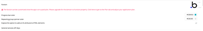

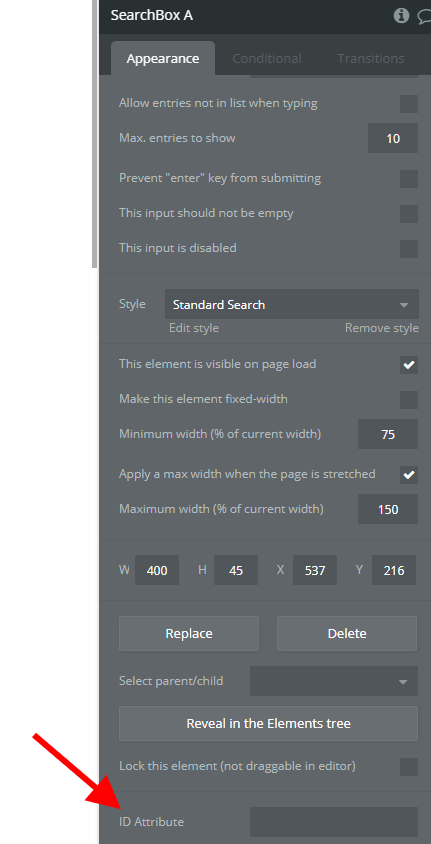

Complementing @boston85719 guidance, by checking the expose option in the settings tab will enable an element’s ID atribute to be set in the inferiormost part of its properties editor. An example with a searchbox element:
Thank you very much for your quick reply and solution
