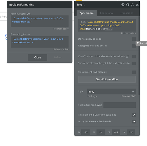

Hi @matisse.serenitrip,
Following thing will do the trick. Quite of a work around but it works.
So what it does it first checking if the person has already had its birthday (set the year of the birthday to current date’s year and check if it is bigger or not).
Then within the formatted as text it just subtracts the years of both numbers and if the person hasn’t had its birthday it subtracts it with 1
Thank you a lot, that’s worked :slightly_smiling_face:
