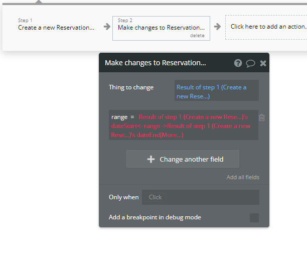

Hello.
How to create a range between two dates ?
Thanks
I have 2 questions
How is ranger defined in the data tab
Are you sure dateStart/dateEnd are date fields in your data tab
You should be able to do this all in 1 step also. Probably No need to modify the record you just created. You can set range when you create the event.

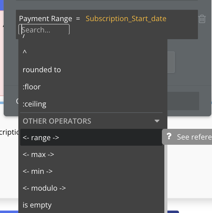

Solution:
Put the first date in the expression, then use the <- range -> operator, then put the second date. It will automatically create a range between the older and newer dates.
Documentation:
